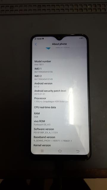

Model = Vivo y91 (1811)

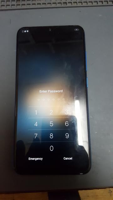

Problem = password at may frp

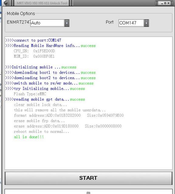

tools = mrt vivo unlock tool & Twiser
Solution = Via Test point
Procedure:
Open MRT Vivo

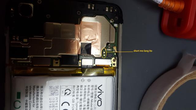

baklas un cp tapos disconect the battery
ito po un test point gamit ang twiser
where is the closest chase
tapus tusok usb then start
Ayun po sapul na

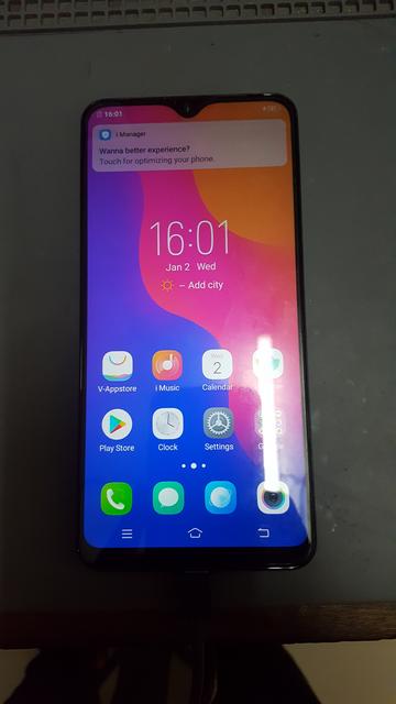

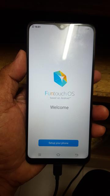

Finish Product:
[url
Maraming salamat po sa pag view mga lodi...
where is the closest chasetapus tusok usb then start
