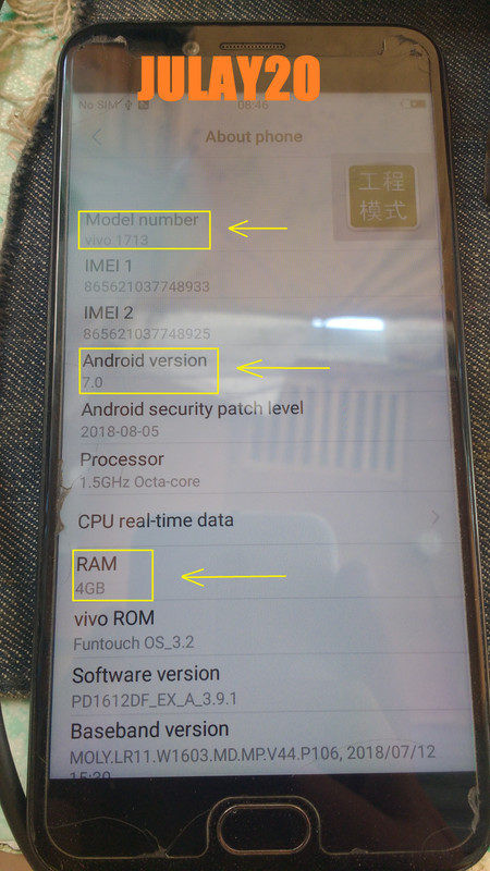

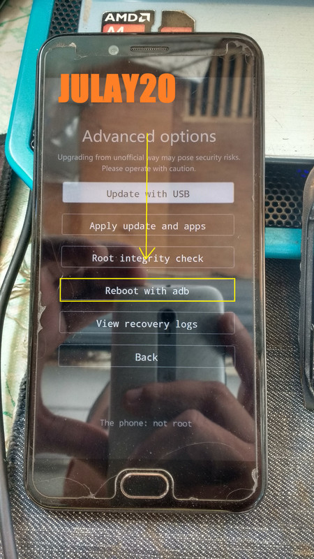

una hanap ako sa tahanan maraming naka gawa pero sinibok ko ayaw talaga anong kolit ko sa mga tools kc wala akong MRT

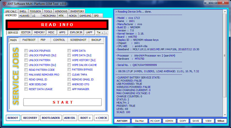

na isip ko FLASH pero kinabahan ako kc dami kong nakita meron 2gb my 4gbmeron pa isa kc tatlo daw ito kaya nag isip ako una naka on namn yung ADB ni read ko sa antsoft ito
INFO:
kaya nag lakas loob na ako na e flash

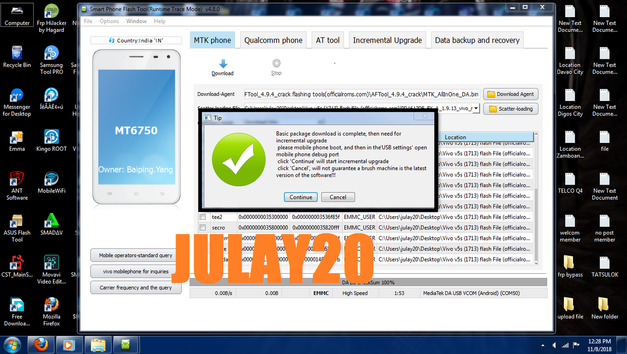

una DOWNLOAD mo ito
FIRMWARE: HARE!!
TOOL: HARE!!
password use tatsulok na lang
ito na sya

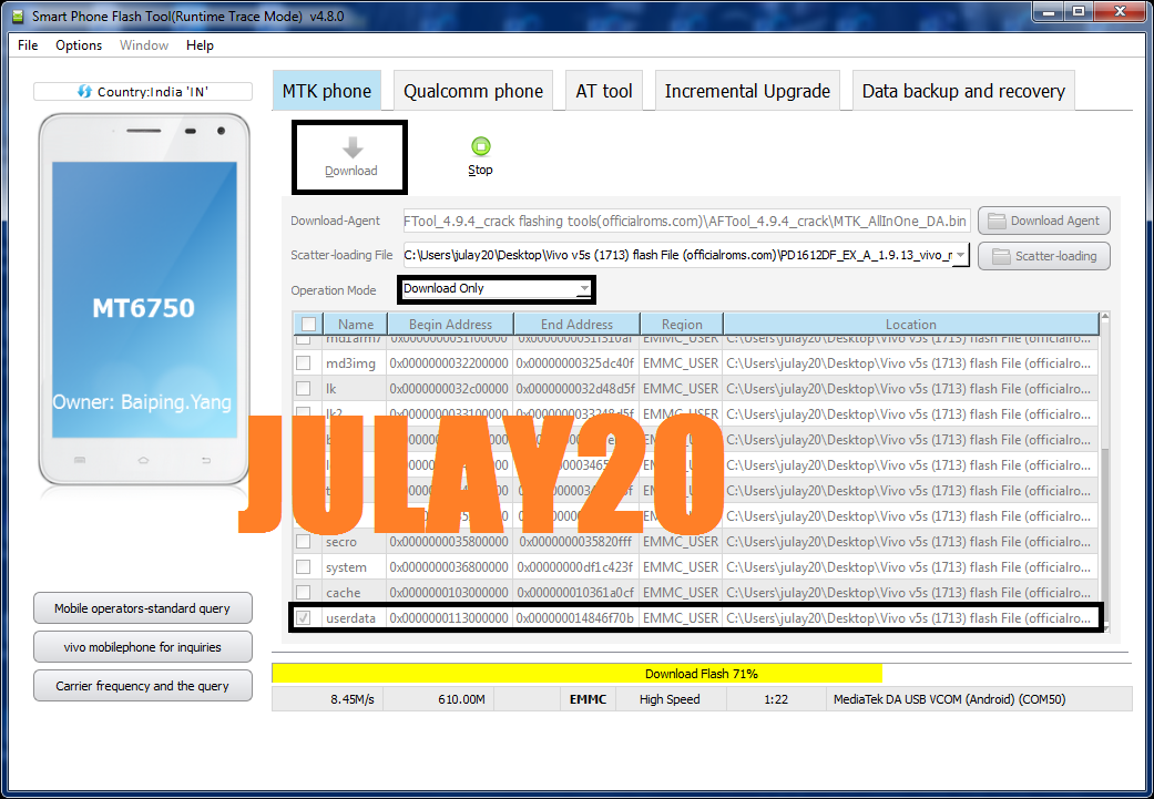

open tool load file stop mona wag e flash agad basa mona dito =)) baka ma dido mo yan =))
uncick mo lahat iwan mo yung USERDATA DOWNLOAD only

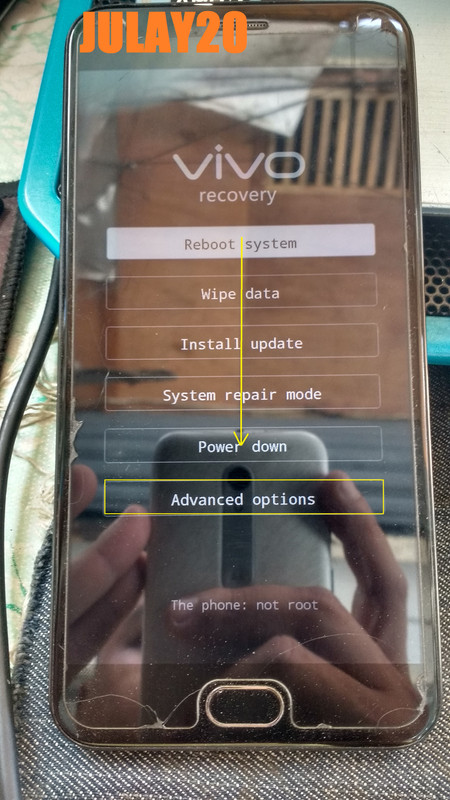

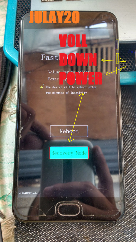

HOLD VOLL UP AND DOWN PARA MAG RUN SALPAK USB HANTAYIN MO MAG RUN
tignan mo ss ko

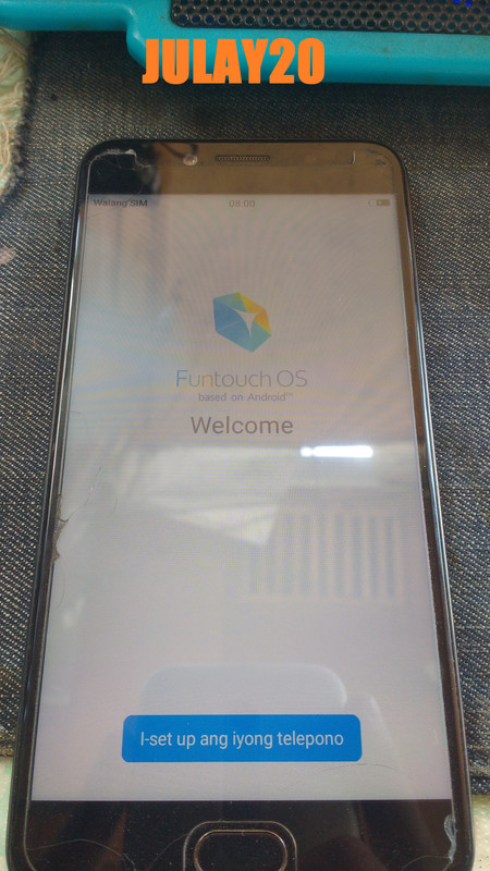

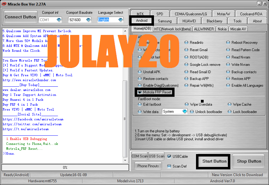

DONE set up mo na pero yung sakin my FRP PA sondan mo namn yung ss ko
open MC CRACK sondan ss
DONE HEHE
INFO:
Code:
> Reading Device Info... done.
- Model : [COLOR="Red"][B]vivo 1713[/B][/COLOR]
- Name : 1601
- Manufacturer : vivo
- Build ID : NRD90M
- Version : [COLOR="Red"][B]7.0[/B][/COLOR]
- Kernel Version : 3.18.
- Board : [COLOR="Red"][B] mt6750[/B][/COLOR]
- Display ID : NRD90M release-keys
- Chipset : 1601
- CPU ABI : arm64-v8a
- Baseband : MOLY.LR11.W1603.MD.MP.V44.P106, 2018/07/12 15:30
- Processor : [COLOR="Red"][COLOR="Red"]AArch64 Processor rev 2 (aarch64)[/COLOR][/COLOR]
- Hardware : [COLOR="Red"]MT6750[/COLOR]
- Serial No. : Q8CYLRAY99999999
- 08:59:17 UP 14 MIN, 0 USERS, LOAD AVERAGE: 11.01, 10.76, 7.32
- CURRENT BATTERY SERVICE STATE:
AC POWERED: FALSE
USB POWERED: TRUE
WIRELESS POWERED: FALSE
MAX CHARGING CURRENT: 0
MAX CHARGING VOLTAGE: 0
CHARGE COUNTER: 0
STATUS: 2
HEALTH: 2
PRESENT: TRUE
LEVEL: 69
SCALE: 100
VOLTAGE: 4037
TEMPERATURE: 390
TECHNOLOGY: LI-ION
> All done.
una DOWNLOAD mo ito
FIRMWARE: HARE!!
TOOL: HARE!!
ito na sya
tignan mo ss ko
DONE HEHE
