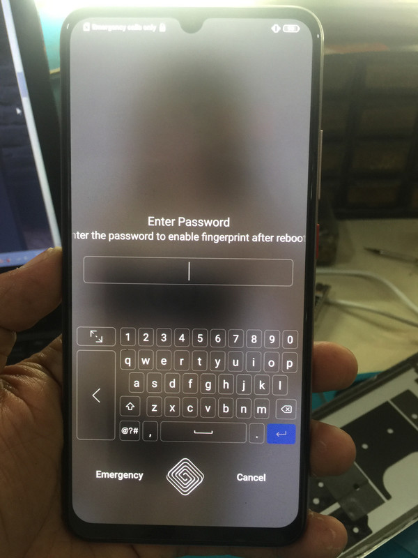

REFERENCE vivo s1 pro 1920 password done via tp in mrt

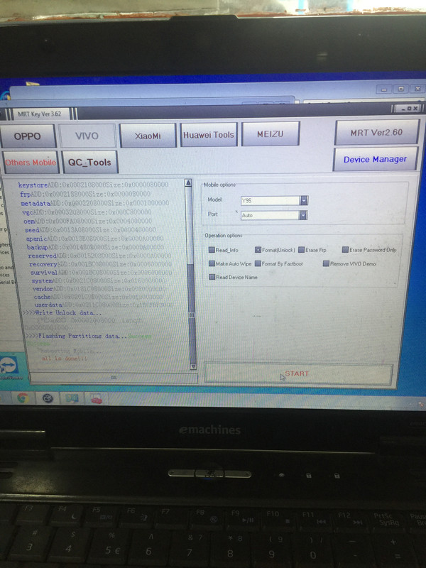

open mrt here download : here or here free no password
click vivo mobile options : model : Y9S port : auto
operastion options : format [ unlock ]

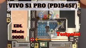

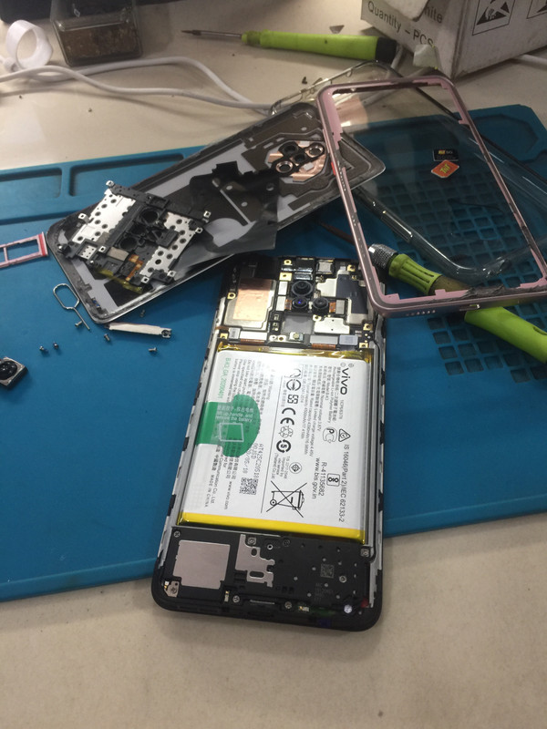

open back ng unit dahil my test piont
tangal battery need: tweezer short testpoint
driver download : here
pag na detect na ang driver bitaw na tweezer wait.. mo lang mag done
testpoint picture:
Tool MRT Picture

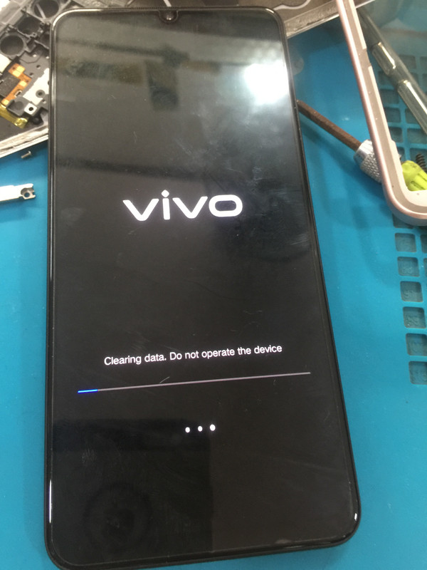

Done "note"
kabit batter power on unit hayan mo lang sia naka tolala mag wayp data factory reset
lang po sia wag na galawin pag ka tapos mag set up next2 mo na lang po wala na yan password at frp :D
hit thanks button ok na :D
