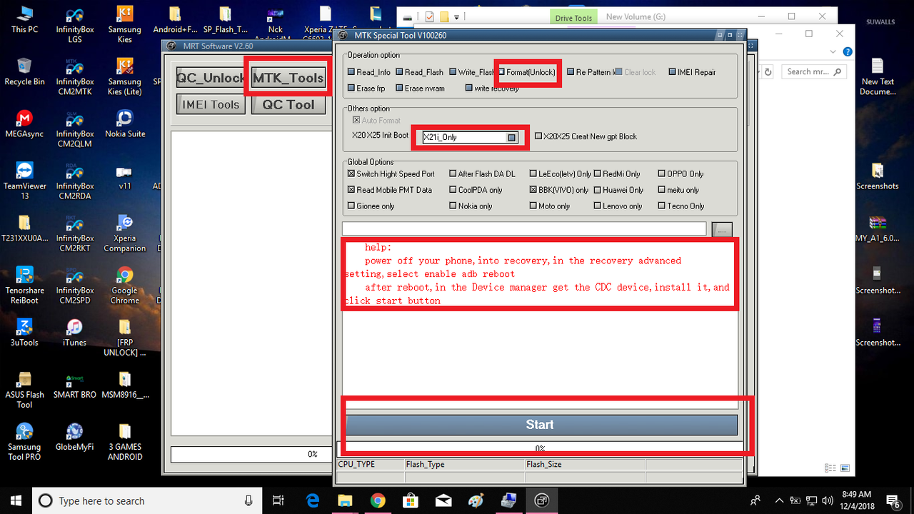

procedure : go to recovery Vol.Up and Power Button (advance option,Reboot W/adb)SAKSAK USB CABLE TO PHONE
open MRT dongle (MTK.Format and Unlock,select BBK Vivo AND CLICK START
SEE SCREENSHOTS..
PASSWORD UNLOCK DONE..

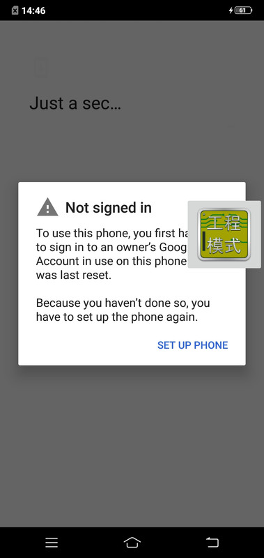

FOR FRP..ERROR KC SA MRT DIKO ALAM PAANO GAWIN KAYA SA Z3X KO TINIRA..

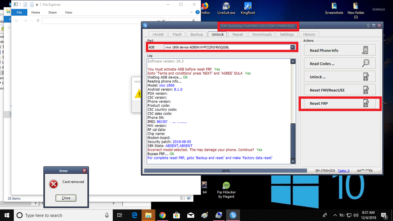

OPEN Z3X PRO..
SAME PROCEDURE PARIN REBOOT WITH ADB IN RECOVERY..
SELECT MODEL 700H/DS
SELECT RESET FRP..
screen shot on windows
