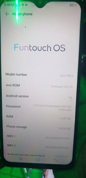

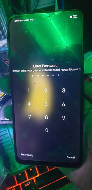

Vivo (1804) or v11 Pro Password lock Problem Remove in UnlockTool

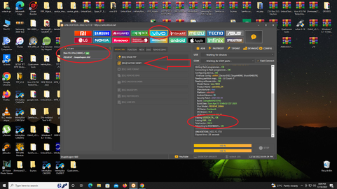

procedure
1: Open: UnlockTool
2: Select: Brand Vivo
3. Search: v11 pro

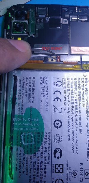

4. Testpoint and Connect USB Cable
5. Click: [EDL] FACTORY RESET and wait it done
TP.
take note: baklas po battery connection
