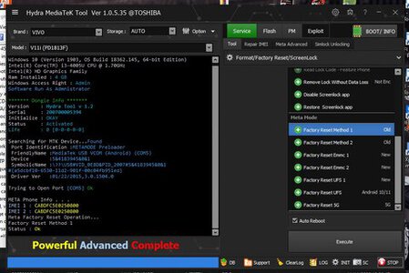

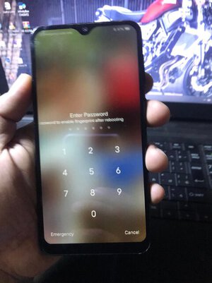

Nag-try muna ako sa recovery pero may password rin sa wipe data
Gamit ang Hydra Dongle
Open MTK Module
Nagtry ako sa Flashmode kaso may error
ERROR : CMD_JUMP_DA
Error sending DA

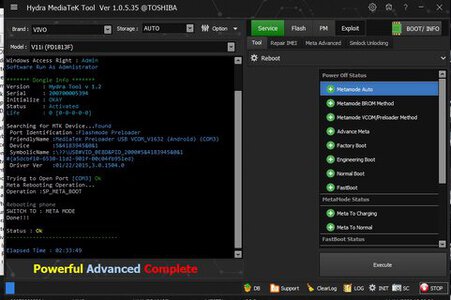

Lipat ako sa Meta Mode
Procedure:
Para mag enter sa meta mode
Select Brand & Model
Service --- Tool --- Reboot
Power Off Status --- Metamode Auto
Execute
Insert usb (bootkey vol up down)
Pag nakita sa screen na naka-meta mode na, remove muna usb
Ngayon, under sa Tool
Format/Factory Reset/ScreenLock
Factory Reset Method 1 Old
Auto Reboot
Execute
Insert usb (no need bootkey kasi naka meta)
Wait lang matapos....

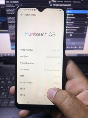

Kung hindi mag-auto reboot. Manually on
Set up

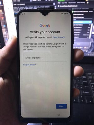

Incase may FRP
idisconnect ang wifi, skip hanggang dun sa add fingerprint
mag-add ng pattern at security questions.
Wag na mag add fingerprint
Back, back lang at i-connect wifi
Click next --- don't copy --- gamitin ang pattern
Makikita nyo may SKIP na sa google account
Ok na po yan
