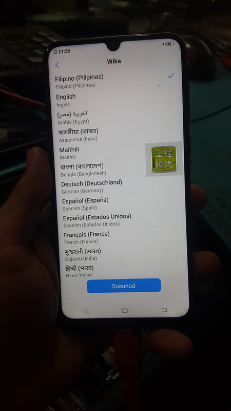

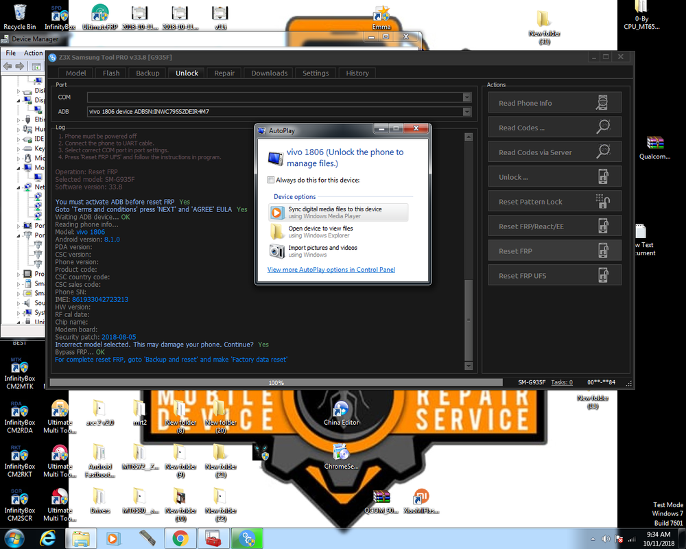

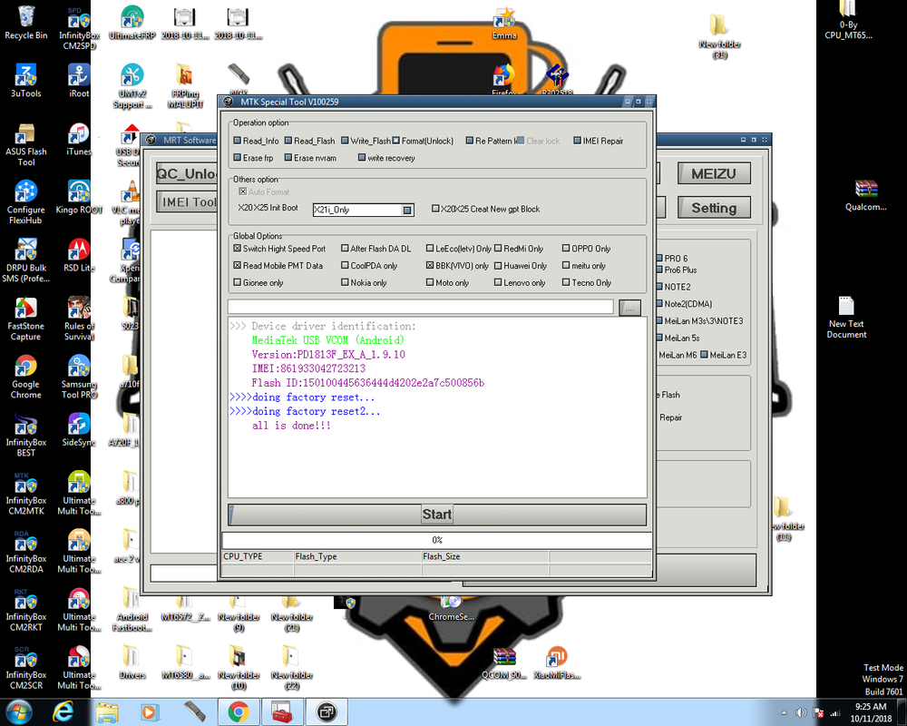

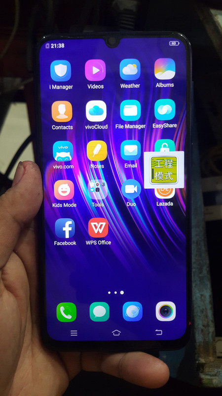

holfd vol + & powe the advance setting the reboot adb then open mo mrt select mo x21 then sa taas forma then salapak mo yung cable intall dapat ang cdc driver then start pag nag all is done ok na . takenote my frp alam nyoba kung pano mag tangal ng frp sa xperia via z3x kung tech ka alam mo nayun
