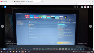

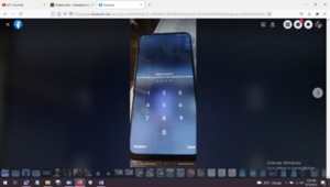

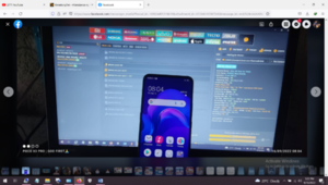

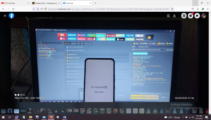

MAND Expired Account Joined Oct 20, 2021 Messages 102 Reaction score 58 Points 201 Location Laguna Sep 16, 2022 #1 STEP 1 OPEN UNLOCKTOOL STEP 2 SELECT VIVO TAB STEP 3 SEACH VIVO V15 CHOOSE NEW SEC PATCH STEP 4 SELECT BROM FACTORY RESET "POWER OFF PHONE" "FOR BOOTKEY SELECT VOL +- " STEP 5 INPUT USB CABLE AND WAIT FOR FINISH STEP 6 IF THERES FRP CHOOSE BROM ERASE FRP AND WAIT FOR FINISH #DONE SEE PICTURES BELOW Last edited: Sep 16, 2022
