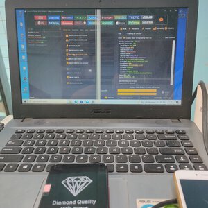

Issue nakalimutan pass.
Kaya let's proceed. . To remove. The password band frp
Procedure
Open unlocktool
Click vivo tab
Click SI vivo v15
Off device vol up/down
Click [brom] factory reset + frp
And chanan. .sorry nakaoff Pala unit. Wala picture Ng finish na Wala na password nagmamadali tumer. Pinalitan ko din Kase LCD sana makatulong pa din...
