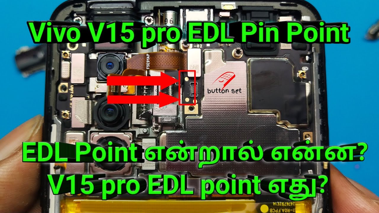

Dinala ni tumer,nakalimutan daw ang password.
1. Open phone for TP.
2. Open MRT software, select Vivo V15 Pro((8/128)
3.Tick (Format/Unlock)
4. Connect Phone to PC with the TP connected and Battery Disconnected
5.Pag detected na sa PC ang phone (QC Loader 9008), click start na sa MRT software. Wait till done.
zulu civ 5
Finished... Sana makatulong sa tahanan.
