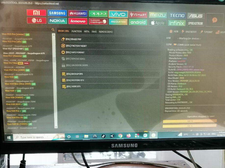

3.Open Unlocktool,Select Vivo Logo,search Vivo V17,select Brom/Edl

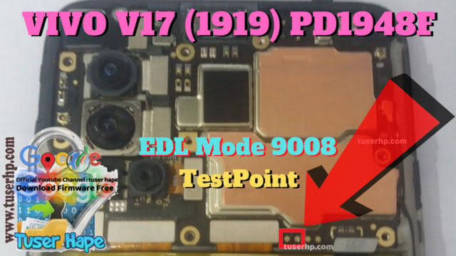

4.Testpoint sabay salpak USB type C cable

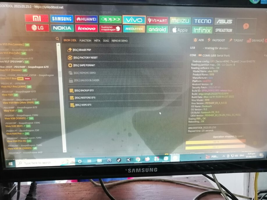

5.kung Mag error ang processing ulit2x lng , Pasensya sa pic Malabo hehehe
View attachment 23390View attachment 23391View attachment 23392View attachment 23393
