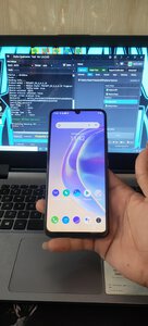

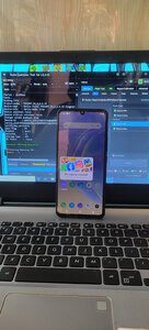

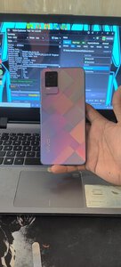

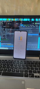

Share ko lang mga master vivo v21e frp remove via fastboot hydra qualcom module no need baklas.
Step:
Off the unit
Open hydra qualcom module
Brand and model auto only
Click vivo
Chose frp remove via fastboot
Hold V+ and plug USB cable then bitawan si V+ kpag nag fastboot na click execute and wait until done
Then restart the unit and setup.
Sana po Maka tulong
