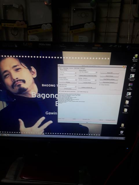

UNA NAG DALAWANG ISIP AKO KUNG TATANGGAPIN KO KC WALA NAMAN AKONG TOOLS NA PANG TANGGAL NITO KAYA BIGLA KONG NAISIP NA PARANG PAREHAS LANG SILA NUNG F1S KAYA TINTRY KUNA BAHALA NA C BATMAN

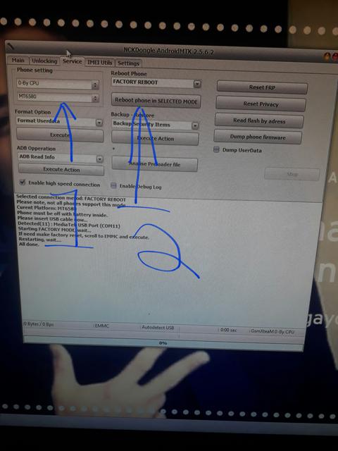

1-OPEN NCK CRACK
SORRY IND KO NA PIC UNG CP NAG MAMADALI UNG TUMER KAYA HINALA KO NAKAW LANG UN .>!
https://s7.postimg.cc/nzv0aj057/20180414_182037.jpg
SUNDAN LANG
OFF UNIT HOLD VOL+
PAG LUMABAS UNG LOGO BITAWAN MUNA UNG VOL+ TAPOS LALABAS NA YONG EMMC
DONE NA SYA ALA NYO NA FRP MADAMING POST DITO SA TAHANAN NTIN.! 1K SINGIL KO.! SMILE KANA PERA NA:D:D:D:D
suwertehan lang din boss pag meron siya option na clear emmc... meron ako nacounter ilang beses negative lumabas si emmc clear.. mas maganda meron talagang box na pang tanggal....
