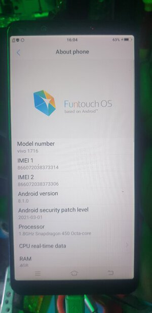

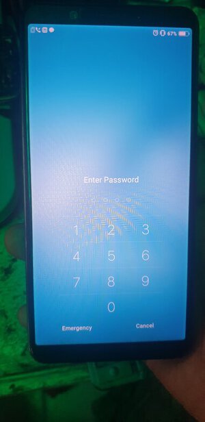

Share ko lang mga boss Vivo V7+ Password lock
Remove by Unlocktool with test point

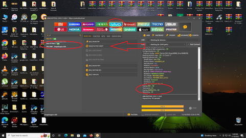

1.Open UnlockTool
2.Select: brand Vivo
3.Search: Vivo V7 Plus edl

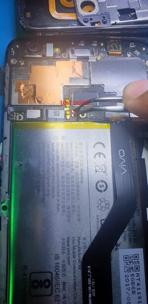

4.test point and Connect Usb Cable

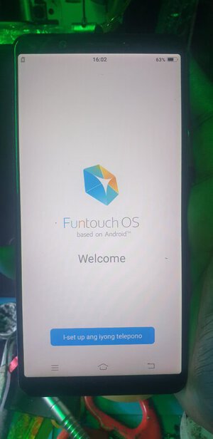

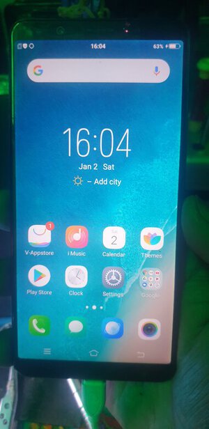

5.Click: [EDL] FACTORY RESET and wait until it done
TP. Tanggal battery connection
