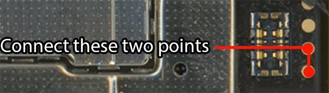

1-TESTPOINT
FOLLOW THE INTRUCTION LIKE THIS

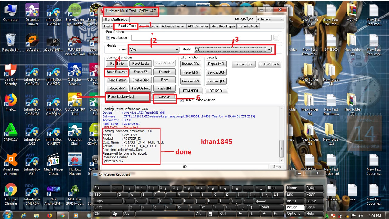

FIRST OF ALL BACK-UP FIRMWARE

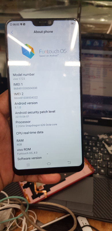

AFTER DO IT MY PROCEDURE PASSWORD BYPASS NO DATA LOSE DONE

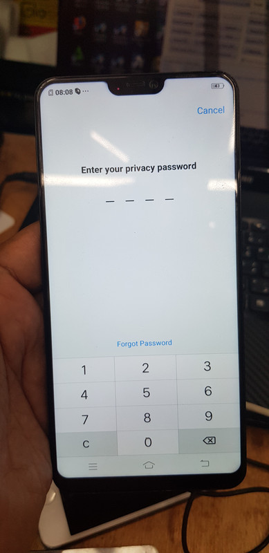

WHEN I OPEN IT THE GALLERY PRIVACY PASSWORD IS ANOTHER PROBLEM

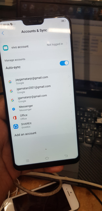

JUST GO TO THE SETTING AND REMOVE FRP AKA GOOGLE ACCOUNT AND RESET ALL SETTING

LOG'S
Device : Vivo V9
Operation : Reset Locks (Vivo)
Checking for existing devices...Not Found
Turn Off phone, hold Vol UP + Vol DOWN and insert USB cable.
Some phones may need Special Boot Cable or TestPoint for EDL mode.
Found Port : Qualcomm HS-USB QDLoader 9008 (COM12)
Driver Info : Huawei Incorporated, qu_usb_serial.sys, 2.1.1.0
Connecting to phone...OK
Waiting for response...Ignored
Init Handshake Sequence...OK
Hardware ID : E1600400 [8953] 00000000
OPK_DATA : 30315EBED1DD09CEAAE927CAE0EE967076BC178CA33718DB4FFF8F02A0E7FAD2
Initializing Protocol...OK
Using Auto Loader Selection [1]
Preparing Loader...Done
Sending Loader [8953_014]...Done
Executing Loader...OK
Detecting Chip Type...OK
Hardware : 8953, eMMC, 64 GB
LU Count : 1 [0x0747C000]
WARNING! High Speed Driver is not installed.
Please install driver from QcFire\Drivers folder using Device Manager.
Payload Info : In: 65536 [4096], Out: 1048576, Sector Size: 512
Reading Partition Table...OK
Reading Device Information...OK
Device : vivo vivo 1723 [msm8953_64]
Software : OPM1.171019.026 release-keys, eng.compil.20190604.194431 [Tue Jun 4 19:44:31 CST 2019]
Android Ver. : 8.1.0
Patch Level : 2019-06-01
USERDATA : Encrypted
Reading Extended Information...OK
Model : vivo 1723
Product : PD1730F_EX
Cust. Name : PD1730F_EX_PH_NULL_NULL
Version : PD1730F_EX_A_1.13.0
Resetting Locks (Vivo)...Done
Please wait for phone to reboot.
Operation Finished.
