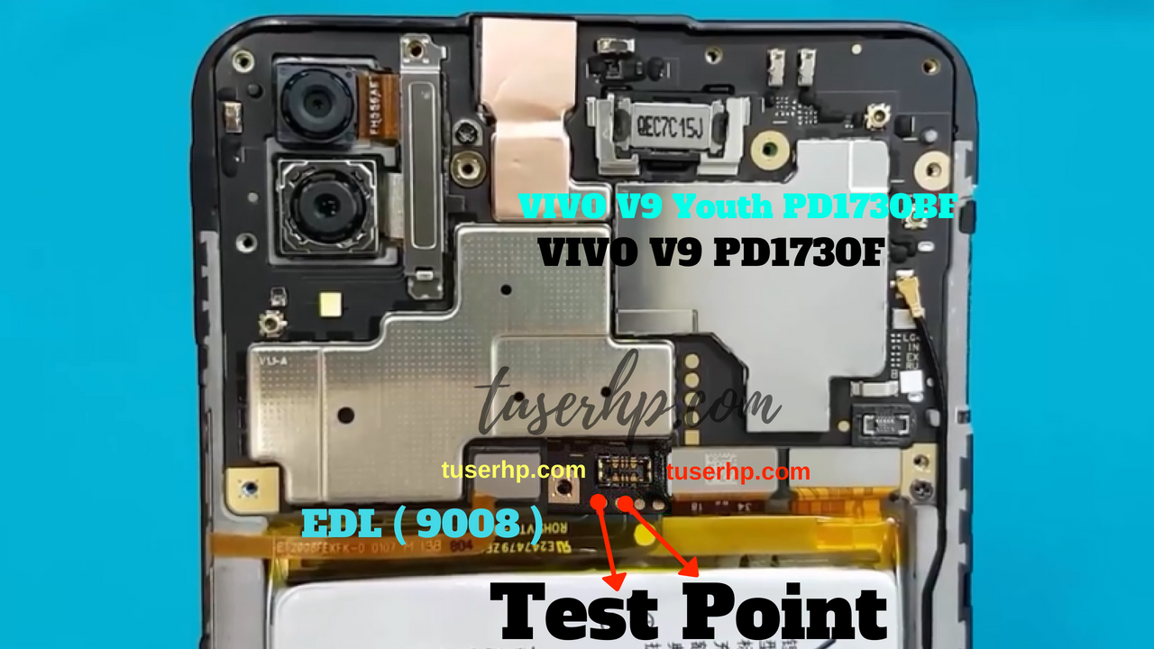

Vivo V9 password and frp done by testpoint
testpoint picture:
logs:
identify
Wait for phone...
Device Found!
Initialize ...
Handshake passed!
ID_BLOCK_I : SnapDragon 625 [MSM8953]
ID_BLOCK_S : 82C30AE9
ID_BLOCK_L : 528DB64DD85F94B24EAEC250CCF3471C
ID_BLOCK_L : 9CC15BAE46AC8B3C85D23677D0340953
Use CM2 Internal Loader
Loader Sent! Initializing ...
Running FireHose on BBID : MSM8953 , FLASH : eMMC , mVER : 1
MemInfo : 0x0003 / 0x0200 / 0x0000000E8F800000 [ eMMC 64 GiB ]
ExtInfo : 0x0001C000/00100000/00001000/00001000/00000200
Storage : MFR : 0x15 , VENDOR : SAMSUNG , NAME : RH64AB
Boot Ok!
Brand : vivo
ProdName : msm8953_64
ProdModel : vivo 1723
Device : msm8953_64
AndroidVer: 8.1.0
Manufact. : vivo
SysPatch : OPM1.171019.011
DevComTime: 5/5/2018 10:10:41 AM
USERData : ENCRYPTED
GCSec : NORMAL
Done!
Elapsed: 00:00:12
format/frp:
Wait for phone...
Device Found!
Initialize ...
Handshake passed!
Boot Ok!
Format USER ...
Format CACHE ...
Format Ok!
Remove FRP
Reset Ok!
Done!
Elapsed: 00:00:21
