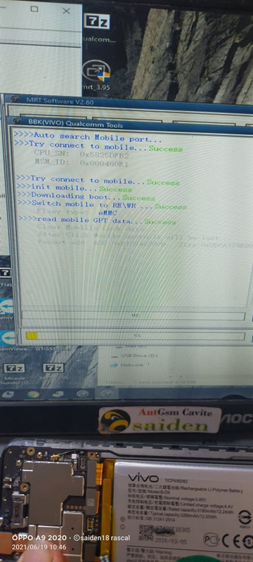

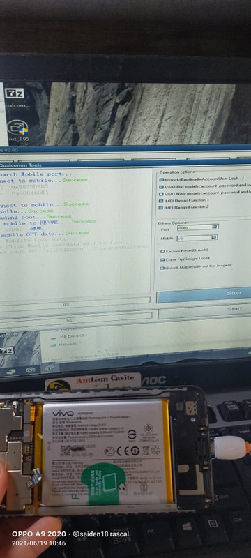

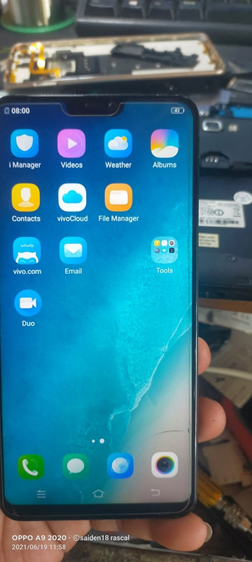

PROCEDURE
VIVO V9 TP
SOLOSYON BY MRT.3.81
OPIN MRT.3.81
CLICK/MRT VER2.60
CLICK VIVO-QC
SELECT/VIVO NEW MODELS< ACCOUNT-PASSWRD ANG FORMAT
SELECT/MOBILE V9
BAKLAS UNIT DETECT MUNA BAGO START
THEN WAITING MO HANGANG
MATAPOS

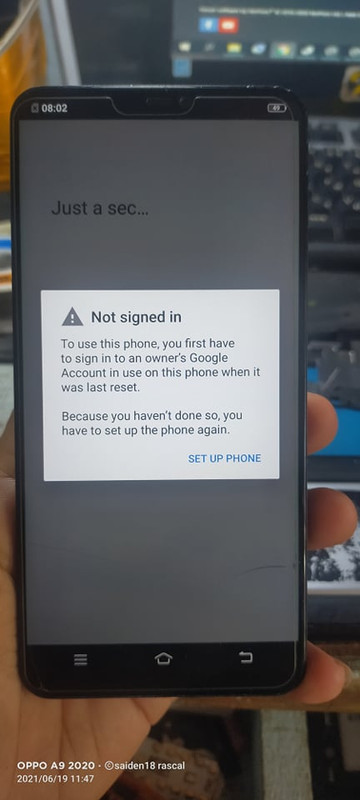

SAME PROCEDURE SA FRP RESET GOOGLE LOCK
beautiful black baby boy

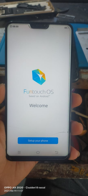

finish product baka makatolong mga boss
