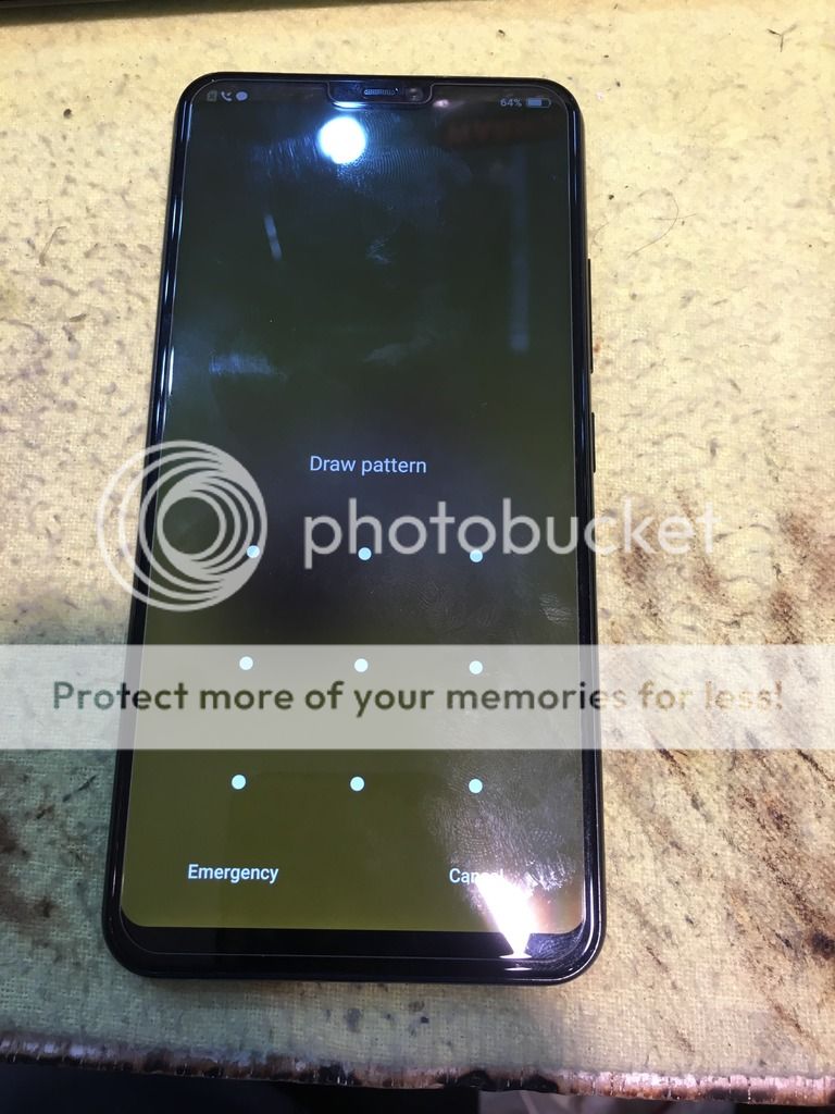

Share ko lang Vivo V9 nakalimot sa pattern Done sa MRT

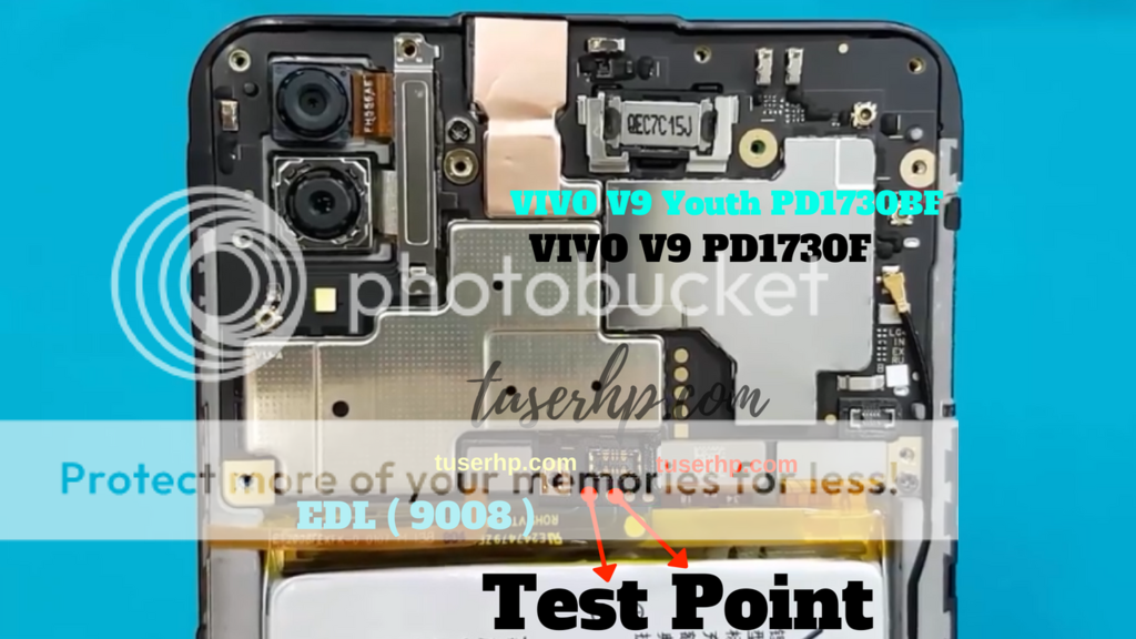

1. open muna ang unit test point kc ito yun TP nya
2. short or jumper. connect mo ulit ang battery tapos insert muna USB to PC install driver if needed..

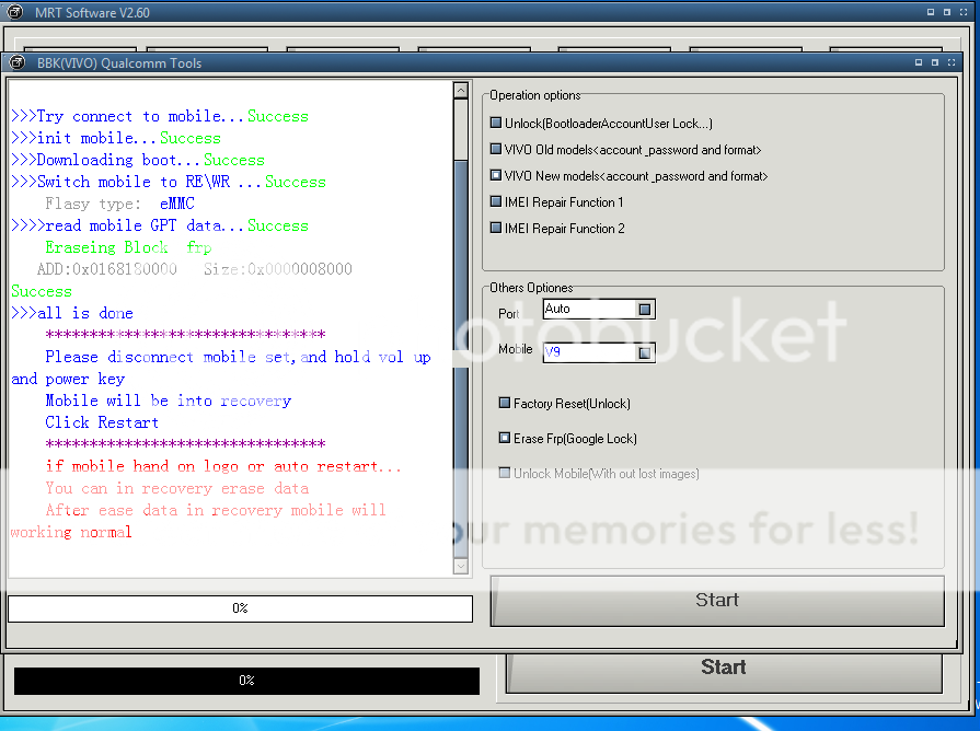

3. Open MRT Dongle and Select BBK(Vivo QualComm tool) select Vivo New Model Account password and format.
4. select Vivo V9 and click factory resetlock and wait till its done in my case after select again erase FRP(Google lock).
