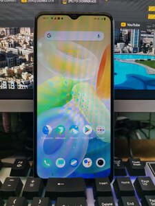

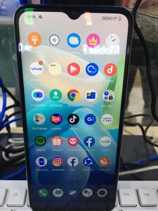

vivo y02s demo mode done via unlocktool

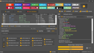

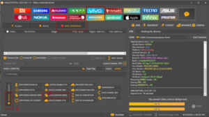

run unlocktool latest version
select mtk universal
select special
click (vivo) remove demo

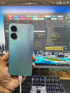

phone in off mode, hold vol- and vol+, then connect usb cable to pc
auto detection, wait till operation completed.
