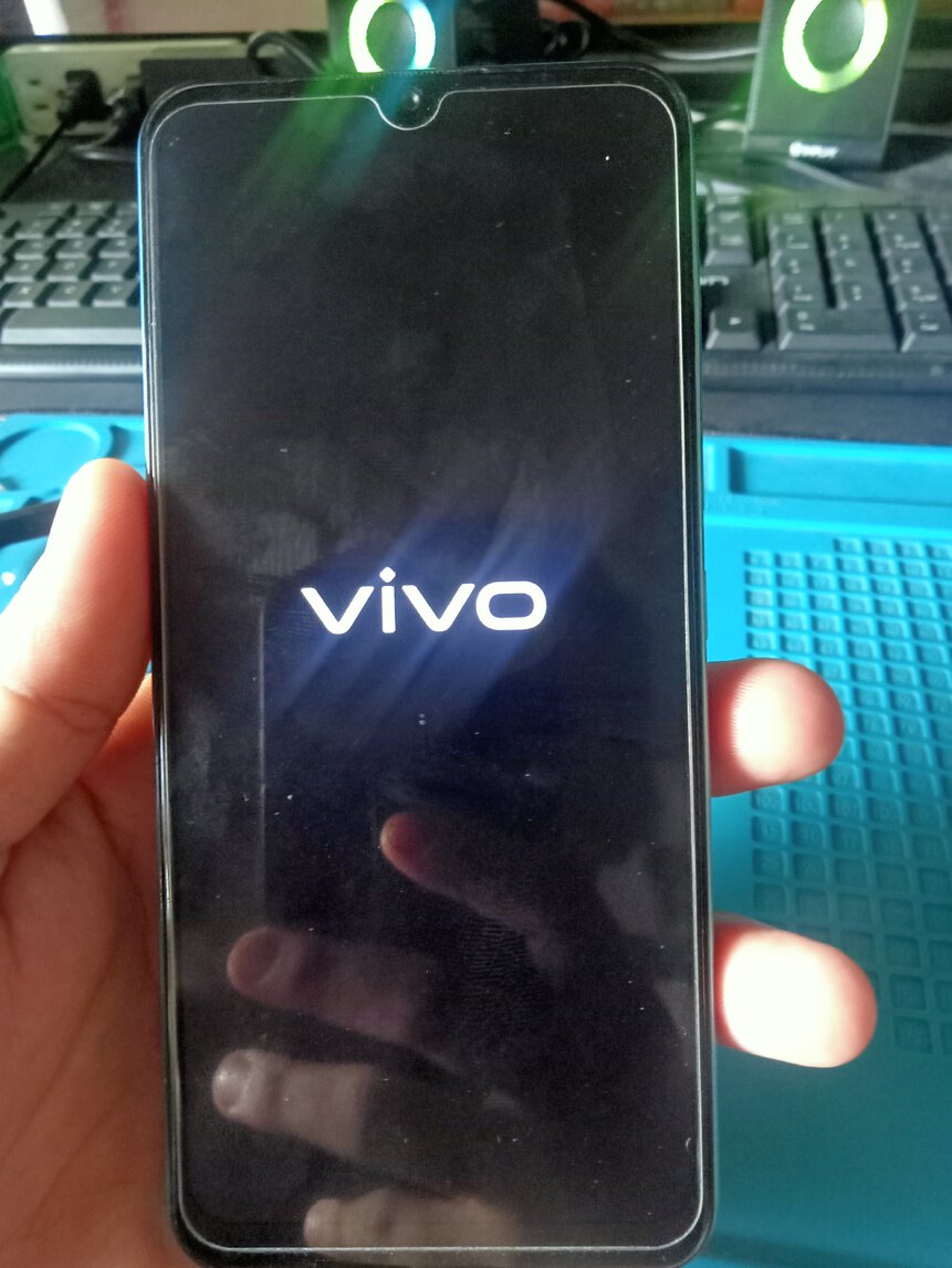

REFERENCE VIVO Y02s (V2203) ...Hang Logo ....

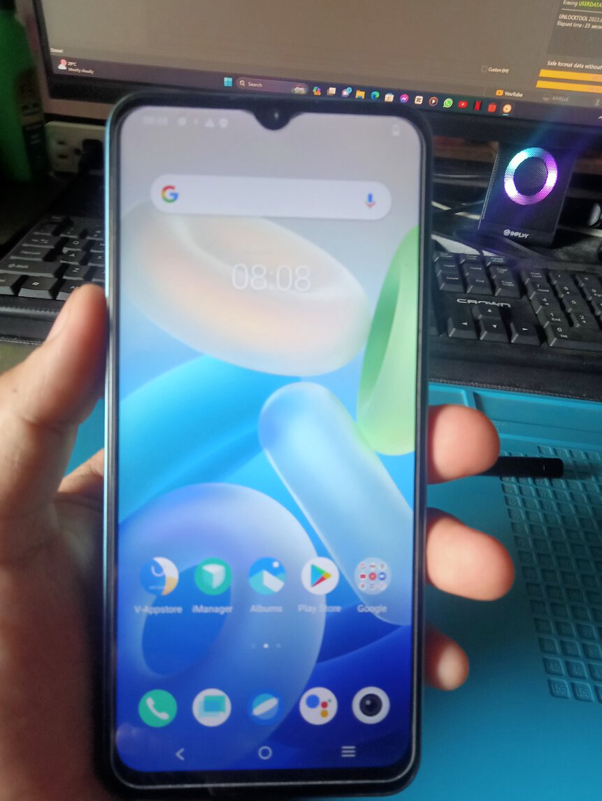

Procedure:
- Buksan mo unit angat mo flex ng battery din balik ..bakit? kasi ayaw mag off kahit e force off kaya kailangan buksan para ma Off yung unit.

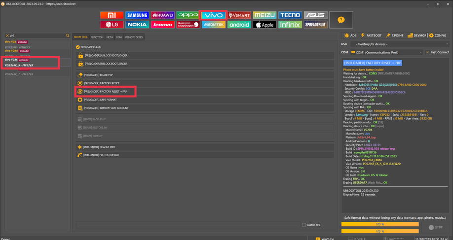

- Open Unlocktool
- Select Vivo tab > Search Vivo Y02s > [PRELOADER] FACTORY RESET + FRP
- Salpak mo cable (no need boot key)
- Antayin matapos
ALL GOODS NA YAN MGA MASTER ..

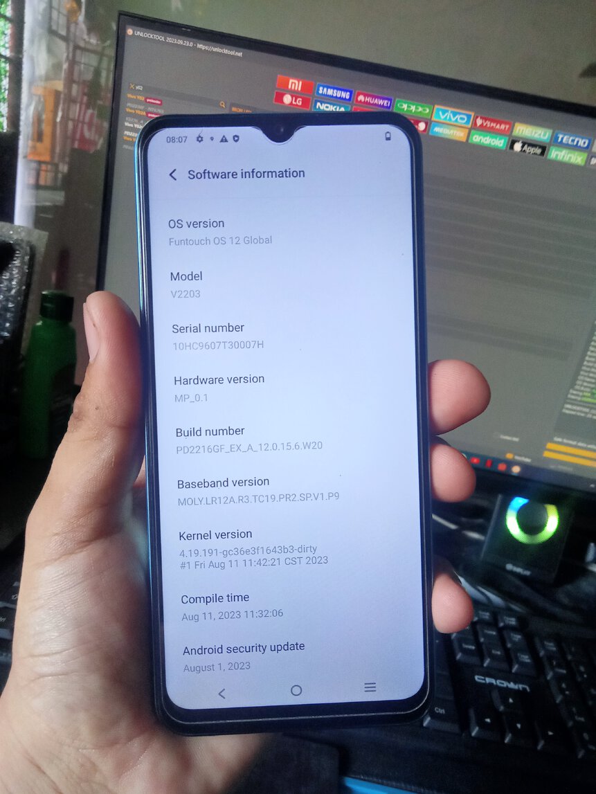

Tested master salamat ☺️
