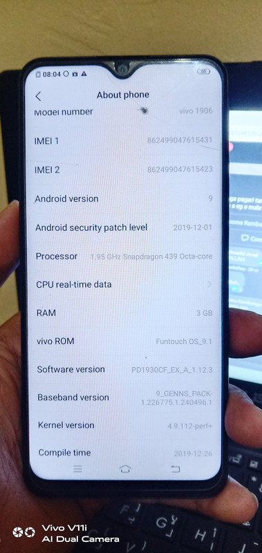

Vivo Y11
Model 1906
3GB Ram
32GB Rom
Android Version 9
History Ng Unit

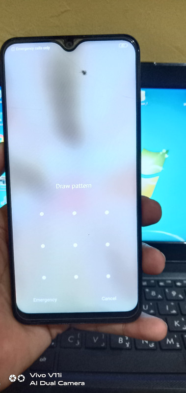

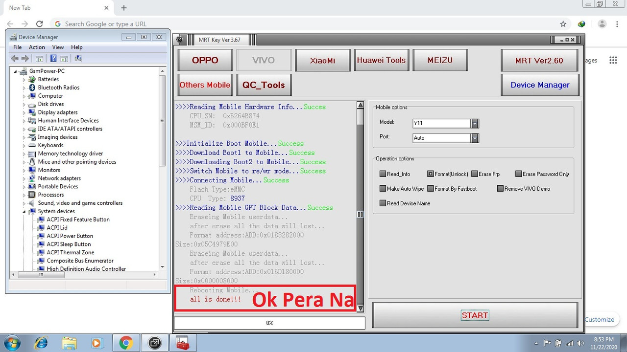

Nakalimotan Daw Ng Anak Ni Tumer Ang Pattern

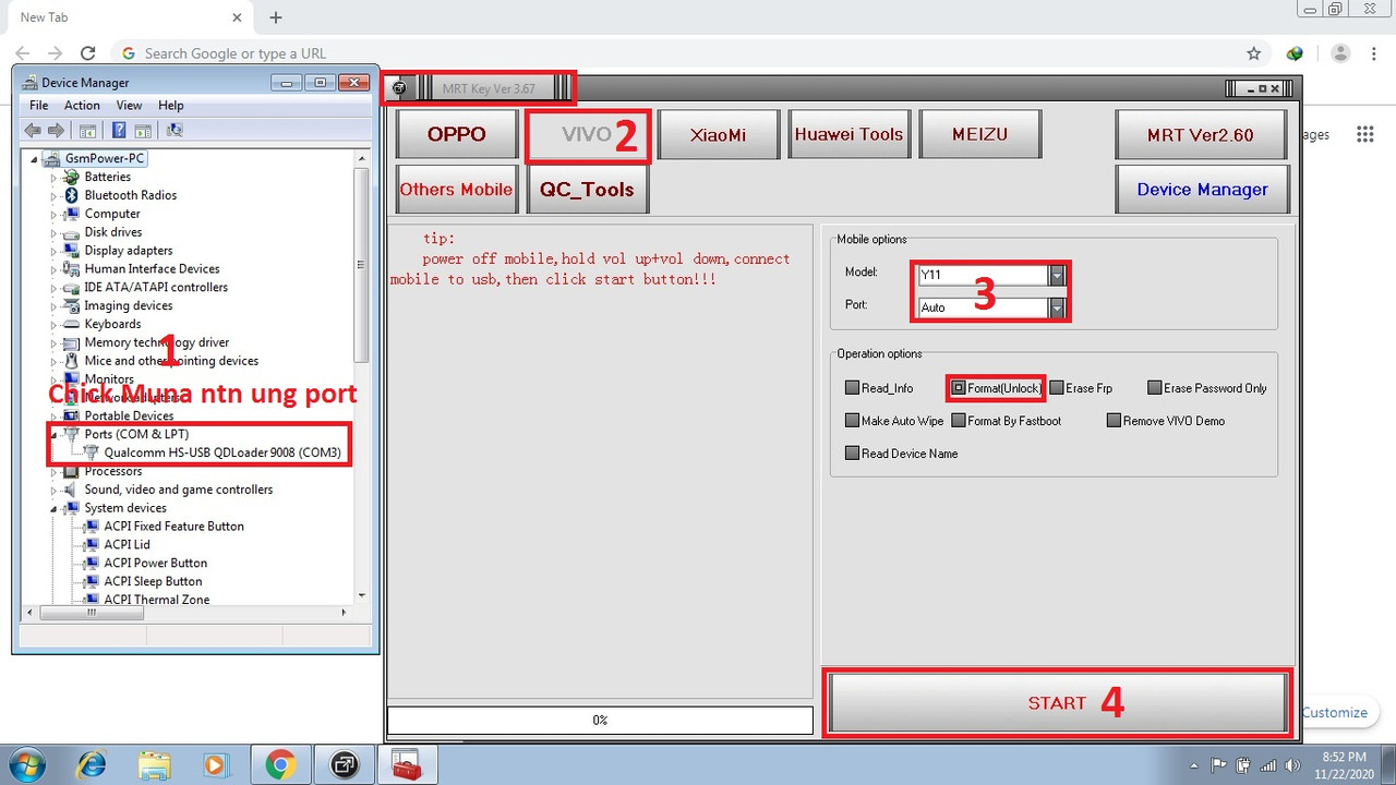

Open Ntn Ang Mrt Selec Vivo Y11 Off Ntn Ang Unit Kausapin Ntn Si Tumer Na Babaklasin Ntn Ang Unit Para Iwas Away Sa Mga Tumer

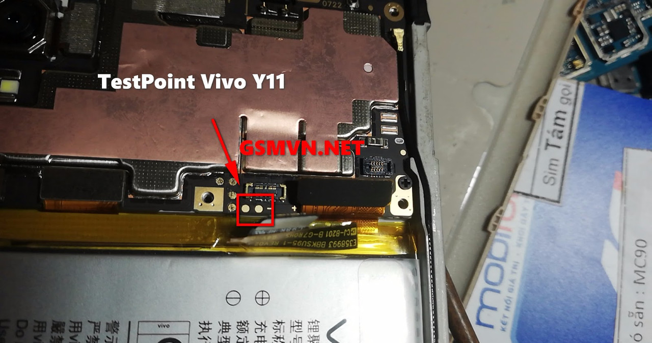

Baka Sabihin Kinahuy Ntn Ang Susunod Step Remove Ntn Ang Battery Tapos TestPoint At Chick Ntn Sa Device Manager Ung Port

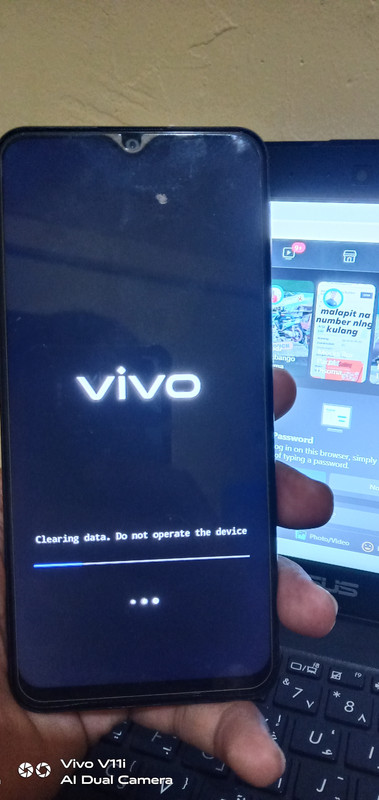

GsmPower Selec Natin Button Like
Maraming Salamat Mga Master
