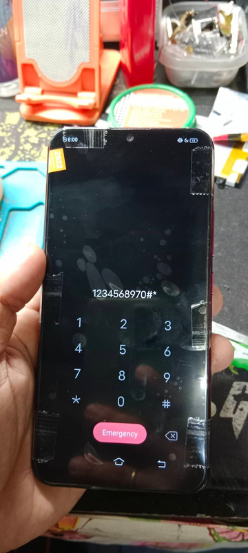

PASSWARD

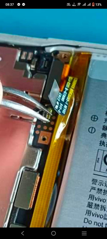

TEST POINT

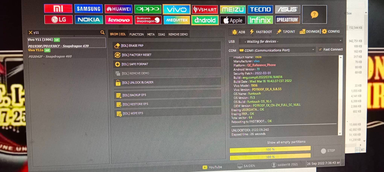

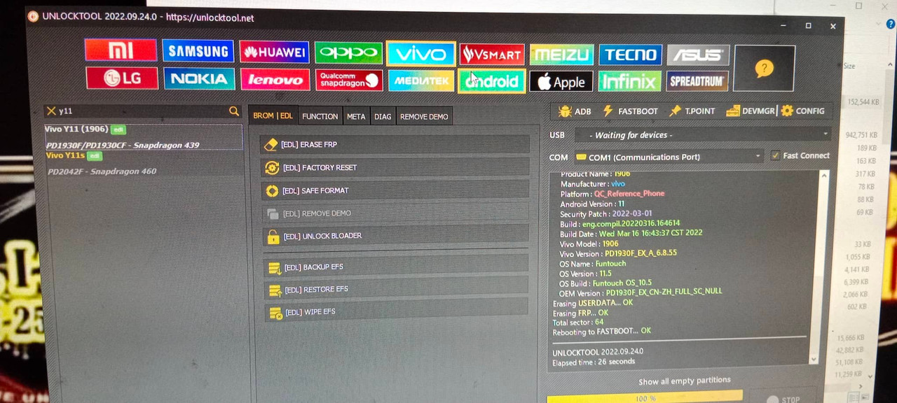

OPIN UNLOCK TOOLS
CLCIK TAB VIVO
SEARCH VIVO Y11 CPH 1906

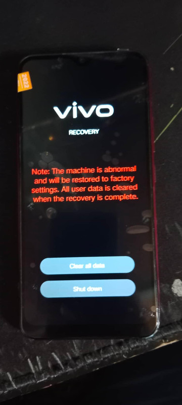

TP MUNA CLICK MO EDL FACTORY RESET
WAITING MO HANGANG MATAPOS

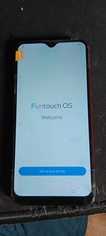

DONE

PASSWARD
TEST POINT
OPIN UNLOCK TOOLS
CLCIK TAB VIVO

top restaurants in hampsteadDONE
