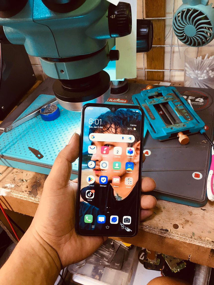

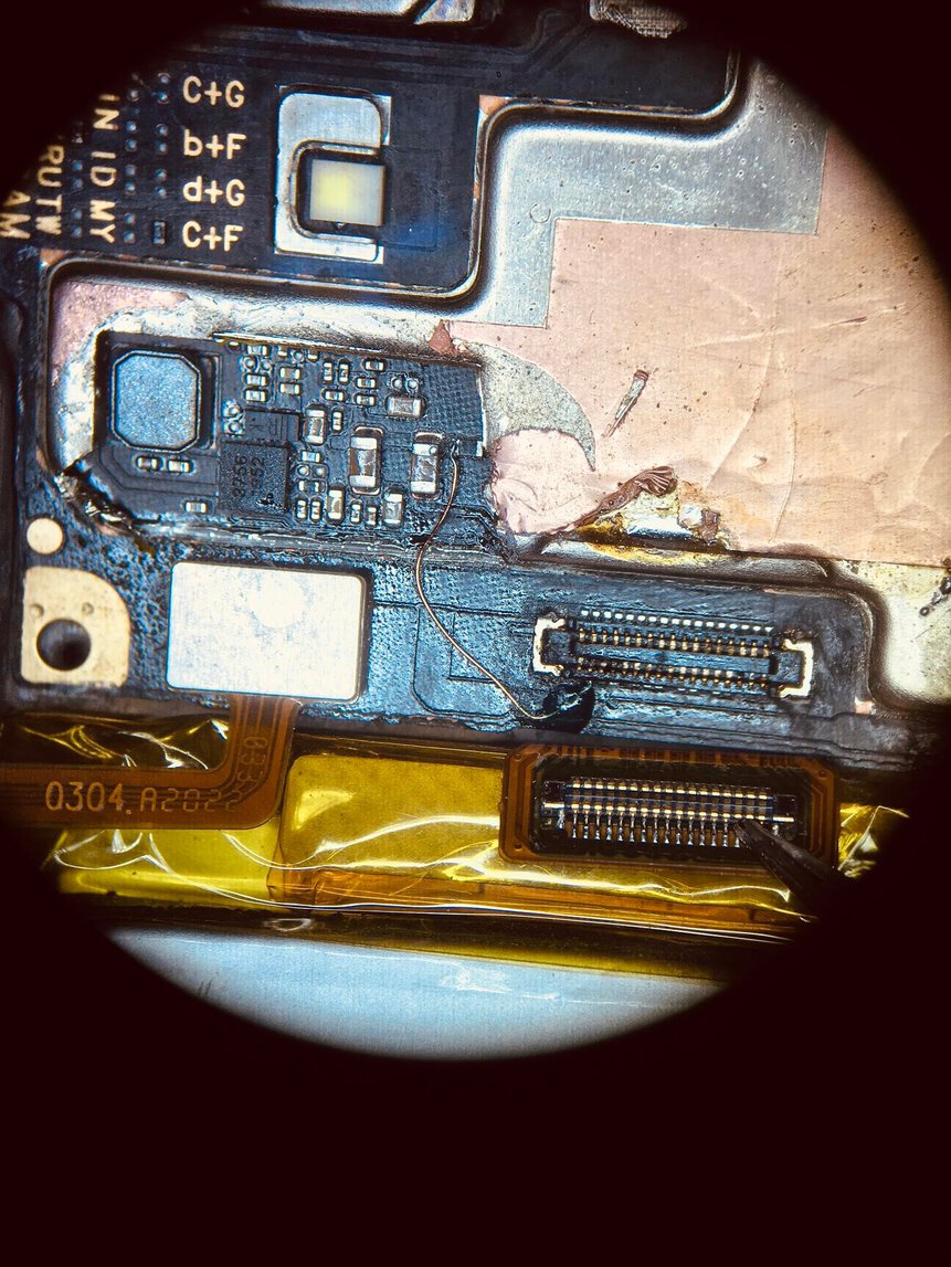

SignUp Now!boss paano pag line 1,2,3 lht wla ok lng ba kht isang jumper lang? or dpt tatlo rin?share lang mga boss vivo y11 no backlight
1 baklas unit
2 palit new lcd no luck same no backlight
3 diode mode reading sa lcd fpc connector found pin no 2 (LEDA) no reading kya jumper n see on pic attached
4.at hndi naman na bigo
1&3 OL yan ung Pin 2 Lng meron dpat palo, kung wala sa pin 2 make jumper like sa pic.boss paano pag line 1,2,3 lht wla ok lng ba kht isang jumper lang? or dpt tatlo rin?
ok na boss salamat d2 hehe1&3 OL yan ung Pin 2 Lng meron dpat palo, kung wala sa pin 2 make jumper like sa pic.
