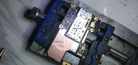

ACTION TAKEN:
try to charge Th e unit no raction in usb voltage reading
kaya binuksan ko unit check batt, drain na
then nxt check terminal batt, sa board ng unit d naman shorted at ala uminit...
SULOTION :

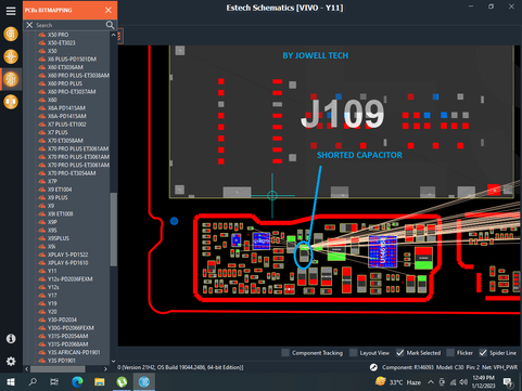

diode Testing reading move using digital tester and ESTECH SCHEMATICS
at un nga nakita ko salarin
capacitor my leak Kaya d umiinit my leak lng sya done....
Just remove leak caps
See in picture,
sana makatulog sa mga kapinoytechnician...

diode Testing using digital tester and ESTECH SCHEMATICS
capacitor my leak Kaya d umiinit leak lng sya done sa diode test move

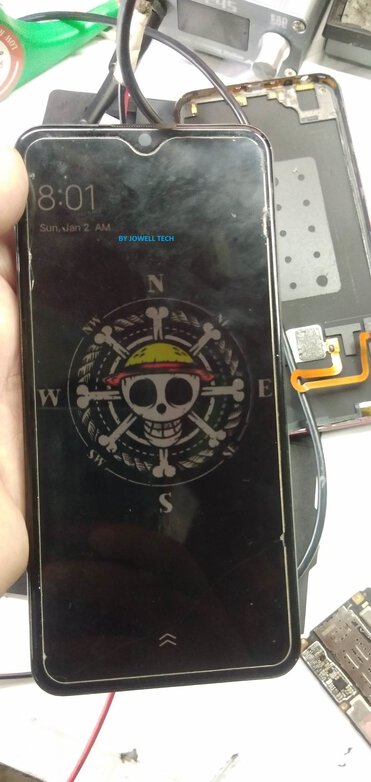

Bali Remove ko lng c.l ung capacitor nasa picture post ko ung caps na inalis ko kng my pamalit galing same unit mas ok sana kaso ala kaya remove ko lng nag ok naman unit
