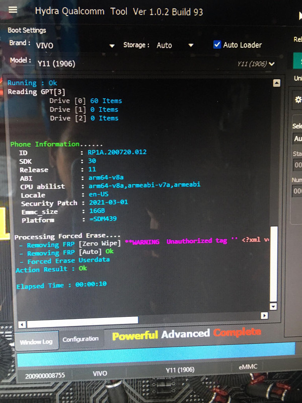

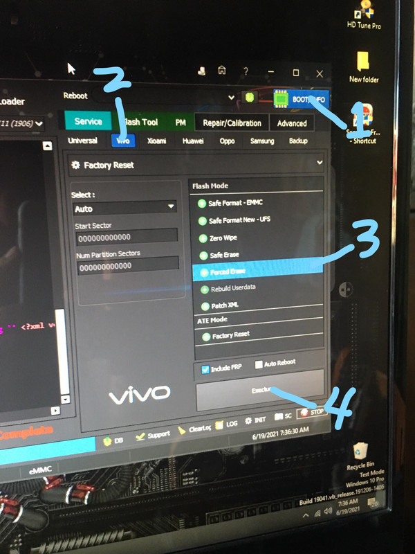

1.open hydra qualcom module

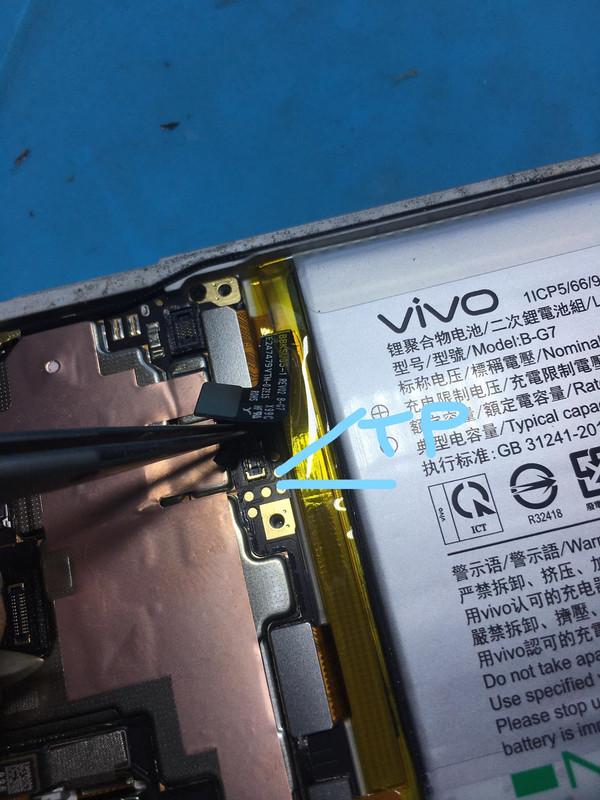

2.select nio model at syempre tp poh tayu
3.alisin battery boot info nio muna kay hydra
pag nadetect at read nya eto nmn
4.wag na sama boot info kc na boot info nio na
5.select vivo tapos force erase then execute
wait nio matapos

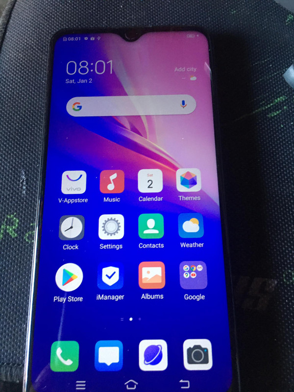

6. pag okay na alisin s pc connect battery then wait may lalabas clear all data
wait uli matapos. at yunn na nga tapos na
