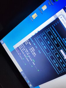

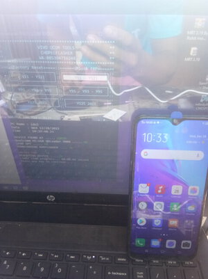

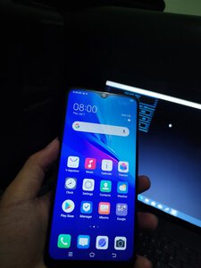

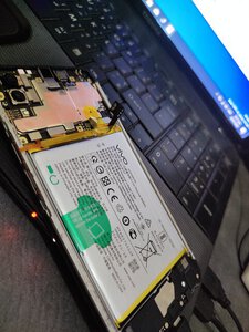

Unit : Vivo y11
solution: Vivo qcom free tools galing dito sa forum

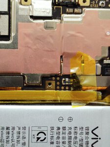

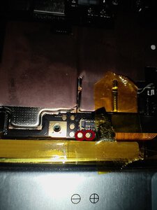

step1: open housing ng vivo
step2: install driver
step3: testpoint tapos saksak sa pc

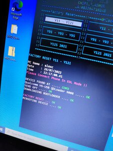

step4: open tools click mo kung reset o frp
(bakit dikomuna inopen tools?, tested ko kasi na inopen ko muna tools tapos testpoimt di agad binasa need mopa irestart tools , so testpoint kana muna)
step5: kung napili mo factory reset , may lalabas maman na rebooting device pwede mona hugutin at ikabit batt, iopen mona at may lalabas na clear data just click clear lang after nyan done,
same procedure reset o frp
NOTE: not working sa windows 7 kaya dapat sa windows 10

Unit : Vivo y11
