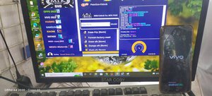

Pra Po sa mga wlang pambili Ng hydra mkakapag remove khit free tools lang tested pa
Vivo Y12s
Password frp
Tools BMB MTK global
Procedure: open BMB MTK select vivo 2022 then sa model select vivo Y12s then off Ang unit press vol up and down connect USB cable hit the format factory reset then wait lang mtapos loading then Pera na
All in one na Kasama na pati frp Nyan
