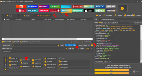

REFERENCE VIVO Y15 DEAD AFTER REMOVE PASSWORD AND FRP UNLOCKTOOL DONE ✅
17
95
112
EdbertJay15
Oct 30, 2022
55
ANDROID 11 PERO NONEED TP PA KAYA NAGAWAN PA PARAAN
CUSTOM EMI SELECT LANG Y12/Y15
AFTER ERASE AUTO MTK PORT
NO LUCK SA BOOT DEVICE
DONE SA FLASHING USING THIS FILE
https://www.mediafire.com/file/5jif...ase-p0.mp3-pre3_mtk6771_GsmMafia.Com.rar/file
ALWAYS CHECK CUSTOM PRELOADER/ EMI AND SELECT Y12/Y15
FLASH
NOTE DI SA LAHAT GUMAGANA AS LONG AS NAPAPABOOT PA SA UT MAY PAGASA PAYAN BASTA DI NADEAD AGAD SA TP PARA WALA PABGALAW KAYA PA GAWAN PARAAAN YAN

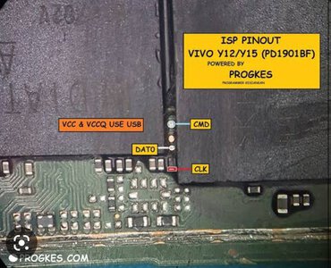

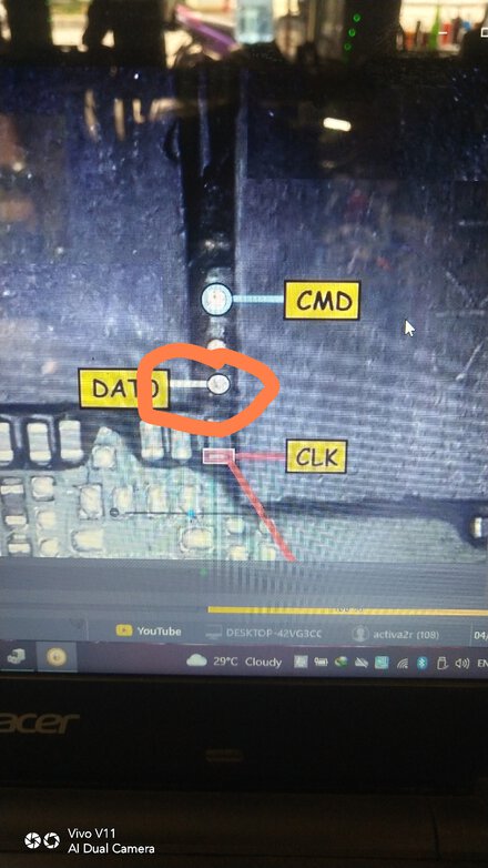

kaya pa buhayin yan via testpoint Unlocktool..
ganito gawin mo..
hanapin mo TP sa unlocktool..
instead na CLK e Tp mo DAT0..
Ung naka circle na Red yan ang e TP..

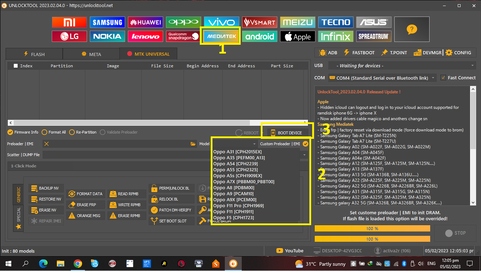

then open unlocktool MEDOATEK TAB..
CUSTOMPRELOADER/EMI select y12-y15..
BOOT DEVICE para makuha mo exact PDF ng phone..
hanap ka dito ng file pagnakuha mo exact flash file load mo ung flash file..
UNCHECK INDEX CHECK PRELOADER then flash..
PRELOADER lng e flash mo buhay yan.
PM mo ako pag di pa rin makuha..
ganito gawin mo..

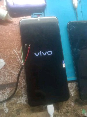

salamat sa tulong sir.. ask ko ulit kung i-TP ko dapat ba nakatanggal ang battery?
eto po pangala kong ginawa sir,,hindi pa ako nag TP jan,success naman sya sir kaso naka-stock na lang talaga sa com port itong cp. possible kaya na sira na-brick ang firmware nito sir sa una kong step na ginawa?

FORMAT DATA Initializing usb... OK
Waiting for device... COM4 [BOOTROM:0E8D:0003]
Bypassing authentication... OK
Analyzing... preloader_k62v1_64_bsp.bin [MT6765:15:2512] [Cust]
Handshaking... OK
Reading hardware info... OK
Hardware : MT6765 [Helio G25|G35|P35] 0766 8A00 CA00 0000
Security Config : SCB SLA DAA
MEID : C3833C881EC61664EB44CB6FA992E1B6
Sending Download-Agent... OK
Syncing with target... OK
Booting device... OK
Syncing with DA... OK
Storage : EMMC - CID : 684A0190.50613943.58000133.77574161
Vendor : SK Hynix - Name : hC9aP3 - Serial : 1096898560 - Rev : 1
Boot1 : 4 MiB - Boot2 : 4 MiB - RPMB : 16 MiB - User Area : 58.24 GiB
Reading partition info... OK [42]
Reading device info... OK
Model Name : vivo 1901
Product Name : 1901
Manufacturer : vivo
Platform : k62v1_64_bsp
Android Version : 11
Security Patch : 2022-02-01
Build ID : RP1A.200720.012 release-keys
Build : eng.compil.20220218.164640
Build Date : Fri Feb 18 16:42:47 CST 2022
Vivo Model : PD1901BF_EXMA
OS Name : Funtouch
OS Version : 9.0
OS Build : Funtouch OS_9
Erasing FRP... OK
Erasing USERDATA... OK
UNLOCKTOOL 2023.01.13.1
Elapsed time : 15 seconds
na boot mo na pala sa UT..
hanap ka file firmware 1901 dito tapos flash mo preloader lng buhay yan naka reset na

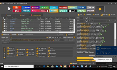

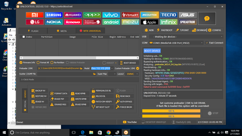

sir na-flash ko na ang preloader,pero bakit kaya ganun parin? eto po ang logs nya.
FLASH Initializing usb... OK
Handshaking... OK
Tips : GPT not initialized! Using scatter as partition map!
Writing preloader_k62v1_64_bsp.bin [247.51 KiB] -> preloader [256 KiB]... OK
Writing preloader_k62v1_64_bsp.bin [247.51 KiB] -> preloader_backup [256 KiB]... OK
Elapsed time : 12 seconds
Handshaking... OK

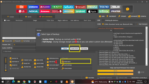

READ BACK UP mo na lng then full flash lahat..

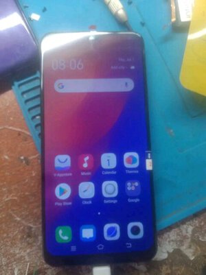

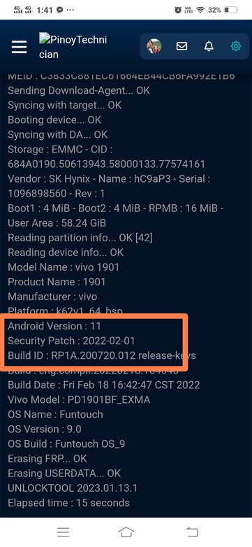

sir okay na po itong phone,,nabuhay na..maraming salamat sa flash file..
Kaya lang version 9 din pala sya? ito kasing tanggap ko e version 11.
may nagpapakita kasi na warning sa may taas bandang battery icon na"Phone Execption" Detected costumized type exception on the phone. The relevant communication feature will be disabled.(systemchanged).
Paanu kaya tanggalin yun sir? Bale nereset ko pala ulit,baka kako matanggal pero wala parin.
ito po sir guide..
pag error ung boot device need mo tp magpa connect..
sir salamat din sa guide mo. Full flash ko na po itong cp gamit itong firmware na link ni TS at nabuhay naman. kaso may nagpapakitang waring sign sa taas bandang battery icon. makikita ni tumer e sigurado tatanungin nya kung anu yun hehe..paanu kaya tanggalin?Bale nereset ko pala ulit,baka kako matanggal pero wala parin.
Tapos napansin ko pala mga sir, sa storage nya lumiit? naging 16GB lang,samantalang ito ay 64GB.

Eto na ang naging android version nya ngaun mga sir pagkatapos ma flash.
BOOT DEVICE Initializing usb... OK
Waiting for device... COM3 [PRELOADER:0E8D:2000]
Jumping to BROM... OK
Handshaking... OK
Product Name : PD1901BF_EX
Manufacturer : vivo
Android Version : 9
Security Patch : 2020-12-01
Build ID : PPR1.180610.011 release-keys
Build Date : Sun Feb 7 18:16:26 CST 2021
OS Name : Funtouch
OS Version : 9

Okay na po ito mga boss. Nabuhay na yung cp. Yung nabanggit kong issue sa taas(post #18) na may warning eh nawala na nung inulit kong i-reflash. Kaso yung yung issue sa storage nya na lumiit gaya ng nabanggit ko sa post #19 e ganun parin at lalong lumiliit ang storage kada reflash ko. Sa Unang reflash ko ang naging storage space nya ay naging 16GB na lang at 12GB ang usable space. Nung inulit kong i-reflash at nawala yung nagpapakitang warning sign(post #18), naging 8GB na lang yung usable space. Baka pag inulit ko pa ulit na i-reflash e magiging 4GB na lang ang usable space hahaha.. Kaya hinayaan ko na lang na ganun. Diko pa kabisado masyado mag-flash sa unlocktool. Baka may paraan pa para bumalik sa dati nyang capacity na 64GB. Pero ngaun hanggang doon na lang muna ang nagawa ko pag ginalaw ko pa ulit baka lalong ma-dedo yung phone,mag-abono pa ako:D:D:D.

Opo sir, at least di na ako mag aabono kay tumer. Maliban lang kung mapansin nya yung storage space ng cp nya e lumiit hehe :D,yun ang problema.
May option sa unlocktool sir na Fomat All at Repartition, nilagyan ko ng check ang mga yun nung sinubukan kong i-reflash yung naback-up kong firmware galing din mismo sa unit na ginawa ko,kaso nag-e-error na sya pagdating sa userdata. Pero na-repartition at na foramat all naman ng unlocktool ng maayus. Nakalimutan kung kuhanan ng logs para mai-post ko sana dito.
Kaya binalik ko na lang ulit na ne-reflash yung firmware galing kay TS. Di na baleng mababa ang storage nya basta buhay :).
dead after format
tao sinbokan ko e revive using preloader wala parin nagyari hangang ganyan lang sya
use test point sir..
yung DAT0 po e connect mo huwag ung CLK..
then full flash mo po marami flash file dito search mo lng
sir may tanggap ako ngaun na ganito. password lang. ang ginawa ko as usual e select ko lang sa unlocktool yun vivo y12/y15 new sec patch. tapos run ko na ang brom factory reset+frp. Ang problema na stock na sa Mediatek USB Com Port itong cp. at Kahit econnect/reconnect ko ang battery ayaw na mag-power ang cp. Pag isaksak ko sa pc,laging com port na lang din sya. pa-help nga sir,salamat.

saken boss di pa ngsuccess pero dead na...naka brom mode xa....kahit na jumper na ung clock
add ko lang TS..
pwede ka mag flash Preloader lng
no need na whole firmware..
pag BOOT Devie mo buhay na yan ..

NA TRY KO PRELOADER LANG SIR KASO AYAW PARIN MABUHAY. KAYA SINUBUKAN KO FULL FLASH. YUN NABUHAY NA, SALAMAT SA INYO MGA KA CO-TECH
eto kaya boss mabubuhay pa
history nyn password tas testpoint q ng ok nman lahat pero hang logo xa kaya inulit q ayan na sumunod.tas d na mag on
