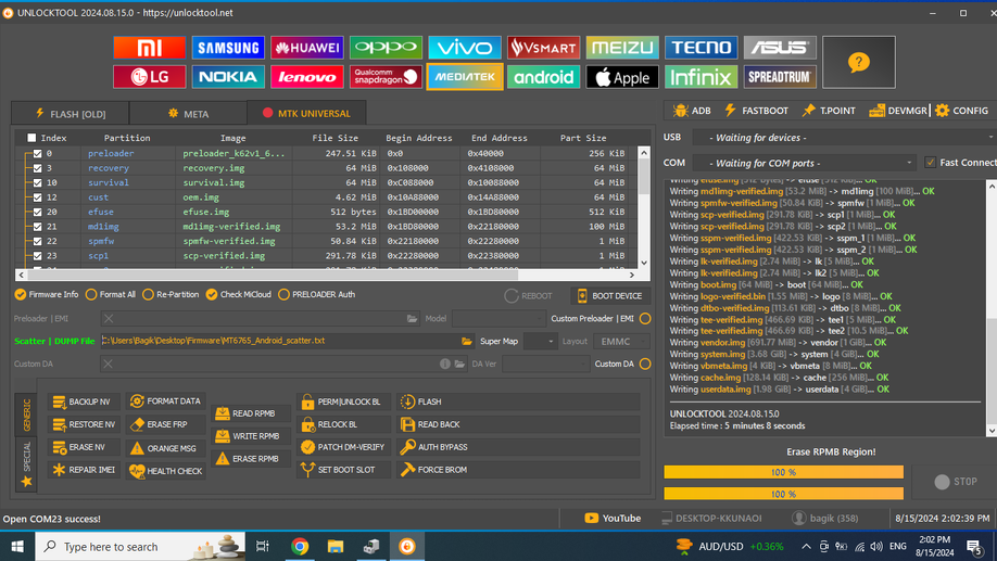

problem of phone hang / always restart in vivo logo
decided to flash using Hydra Tool this is the firmware i use to flash but dead
but revive by Unlock Tool same firmware i use to flash
see picture below.
boot key: no need cos always detected mediatek usb driver if insert usb cable
FLASH Initializing usb... OK
Waiting for device... COM23 [BOOTROM:0E8D:0003]
Bypassing authentication... OK
Analyzing... preloader_k62v1_64_bsp.bin [MT6765:14:2352] [Cust]
Handshaking... OK
Reading hardware info... OK
Hardware : MT6765 [Helio G25|G35|P35] 0766 8A00 CA00 0000
Security Config : SCB SLA DAA
MEID : C4EF4B16036F13DC78729DCA34C0A559
Sending Download-Agent [1]... OK
Syncing with device... OK
Booting device... OK
Syncing with DA... OK
Storage : EMMC - CID : 52000115.4D343650.9FE40142.35C6DF68
Vendor : Samsung - Name : RP64MB - Serial : 3748175844 - Rev : 1
Boot1 : 4 MiB - Boot2 : 4 MiB - RPMB : 16 MiB - User Area : 58.24 GiB
Tips : GPT not initialized! Using scatter as partition map!
Writing preloader_k62v1_64_bsp.bin [247.51 KiB] -> preloader [256 KiB]... OK
Writing preloader_k62v1_64_bsp.bin [247.51 KiB] -> preloader_backup [256 KiB]... OK
Writing recovery.img [64 MiB] -> recovery [64 MiB]... OK
Writing survival.img [64 MiB] -> survival [64 MiB]... OK
Writing oem.img [4.62 MiB] -> cust [64 MiB]... OK
Writing efuse.img [512 bytes] -> efuse [512 KiB]... OK
Writing md1img-verified.img [53.2 MiB] -> md1img [100 MiB]... OK
Writing spmfw-verified.img [50.84 KiB] -> spmfw [1 MiB]... OK
Writing scp-verified.img [291.78 KiB] -> scp1 [1 MiB]... OK
Writing scp-verified.img [291.78 KiB] -> scp2 [1 MiB]... OK
Writing sspm-verified.img [422.53 KiB] -> sspm_1 [1 MiB]... OK
Writing sspm-verified.img [422.53 KiB] -> sspm_2 [1 MiB]... OK
Writing lk-verified.img [2.74 MiB] -> lk [5 MiB]... OK
Writing lk-verified.img [2.74 MiB] -> lk2 [5 MiB]... OK
Writing boot.img [64 MiB] -> boot [64 MiB]... OK
Writing logo-verified.bin [1.55 MiB] -> logo [8 MiB]... OK
Writing dtbo-verified.img [113.61 KiB] -> dtbo [8 MiB]... OK
Writing tee-verified.img [466.69 KiB] -> tee1 [5 MiB]... OK
Writing tee-verified.img [466.69 KiB] -> tee2 [10.5 MiB]... OK
Writing vendor.img [691.77 MiB] -> vendor [1 GiB]... OK
Writing system.img [3.68 GiB] -> system [4 GiB]... OK
Writing vbmeta.img [4 KiB] -> vbmeta [8 MiB]... OK
Writing cache.img [128.14 KiB] -> cache [256 MiB]... OK
Writing userdata.img [1.98 GiB] -> userdata [4 GiB]... OK
UNLOCKTOOL 2024.08.15.0
Elapsed time : 5 minutes 8 seconds

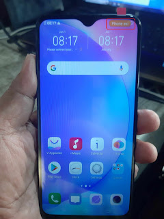

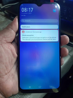

but after flash there's phone exception

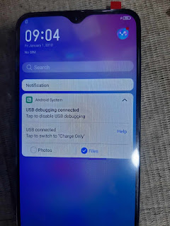

to remove Phone Exception download this Tool or Watch Video
