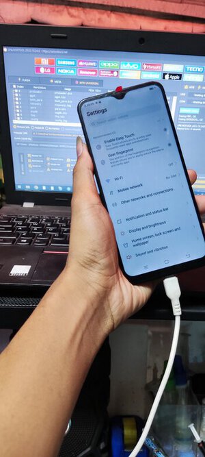

VIVO Y15 NEW SEC PATCH ERROR

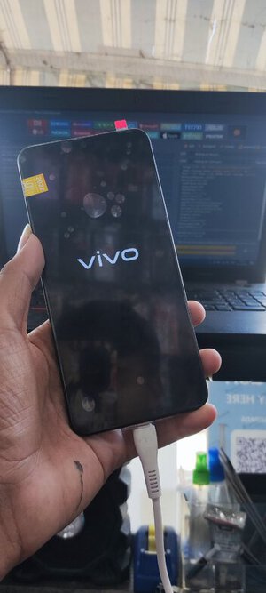

PEOCEDURE SA NEW SEC PATCH ERROR YUNG MGA WALA NG OPTION DINA KAYA SA TESTPOINT AND VOLUME UP AND DOWN ITO PO PROCEDURE AND WORKING NAMAN PO SAKN.
Open Unlocktools
Click vivo y15 new sec patch Factory reser and frp.

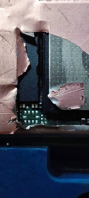

HANAPIN NYO YUNG DAT-0 SEARCH NYO SA GOOGLE TAPOS CONNECT NYO SA GROUND THEN SALPAK NYO SA PC OR LAPTOP
TIMING LNG PO WAG NYONG TAGALA PAG TESPOINT PAG KTA NYONG NAG DETECT BITAW AGAD KASI PWEDENG MAMATAY ANG PHONE
TIMING LNG PO MGA MASTER❤️
SANA MAKATULONG SA INYO
PASENSYA NAPO SA IMAGE DAHIL DI AKO MAGALING MAGEDIT NG PICTURE
PM NYO LNG AKO PAG DI NYO PA DN MA GETS SALAMAT
test point
may ganyan din akung unit ngaun y15 new patch cgro e2 error sa box eh..ok sana itong thread kung mas clear ung information..
medyo dilikadong paraan to..pero try ko kung may maligaw..tnx boss
