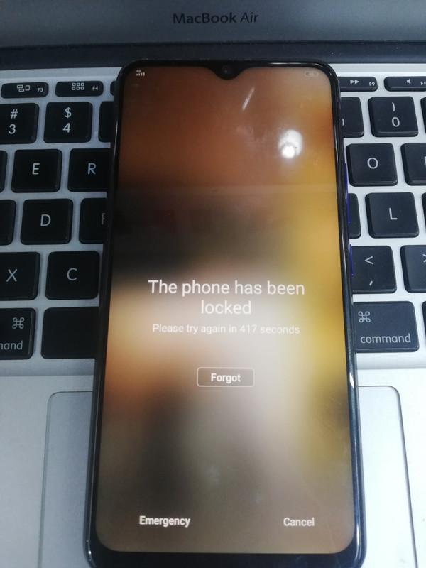

REFERENCE Vivo Y15 The phone has been locked bypass done by MRT.

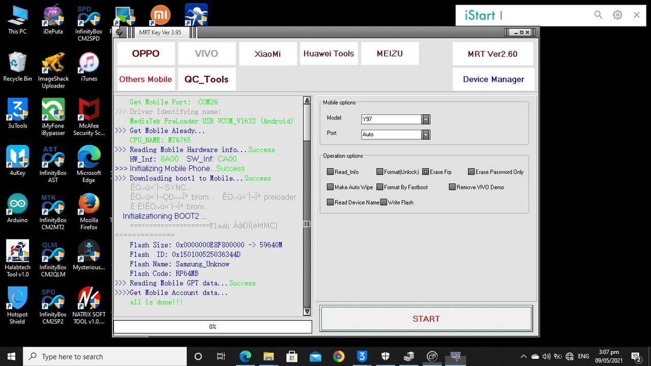

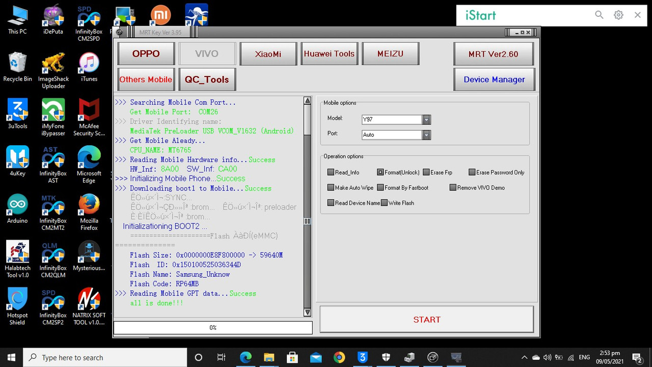

Action Taken:
Open MRT
Select VIVO Y97
Click FORMAT UNLOCK
Start
Off the Phone , NO BOOTKEY NEEDED.
Insert usb cable
DONE.
Setup the phone, pag humingi ng frp
Ulitin ang proseso by this time select
ERASE FRP
Done.
