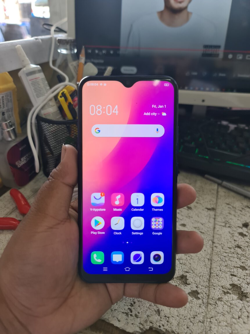

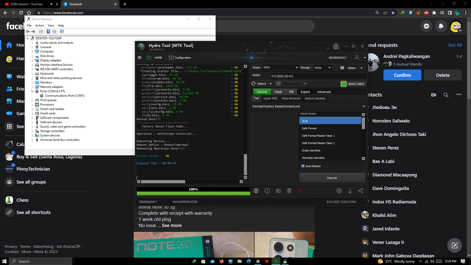

Vivo Y15 (vivo1901) Password/FRP SANA MAKATULONG

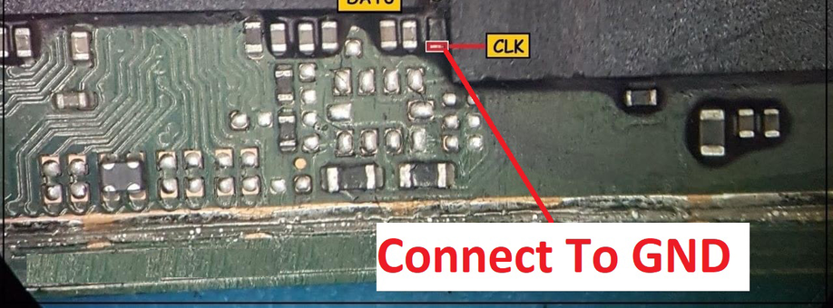

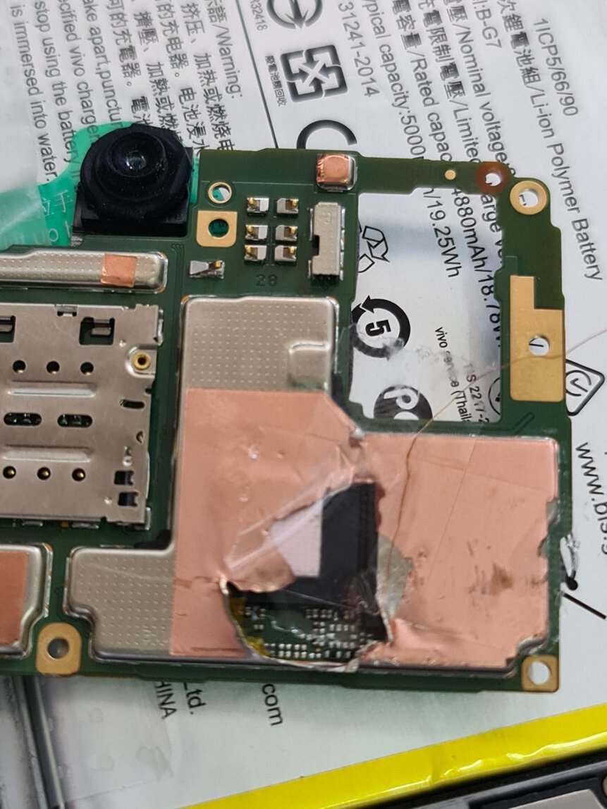

1ST. need muna nating baklas kase need pa kase ng TP o pinout boss

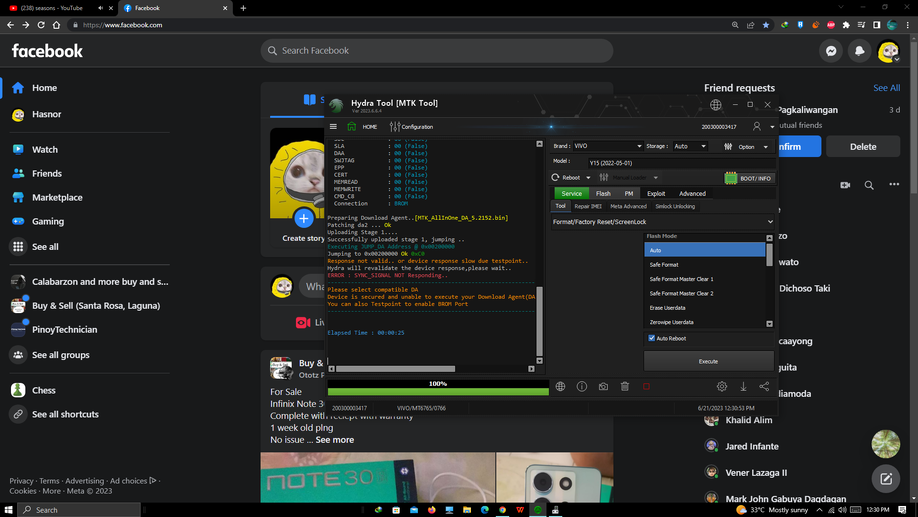

2ND. OPEN MO NA YONG HYDRA AND CLICK MEDIATEK
THEN SELECT BRAND VIVO THEN SELECT MODEL Y15(2022-05-01)
3RD. CLICK AUTO THEN CLICK EXECUTE TAPOS SABAY TP AND SALPAK
4TH. THEN KUNG MAG ERROR MAN MGA BOSS AT GANTO LUMABAS

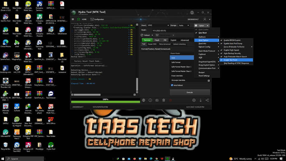

MAY NEED KALANG AYUSIN CLICK MO (OPTION) THEN (BOOT OPTION) TAPOS ENABLE MO LANG YONG (ENABLE TESTPOINT)
TAS TP AND SALPAK MO NALANG ULE MGA BOSS
ETO EXAMPLE MGA BOSS

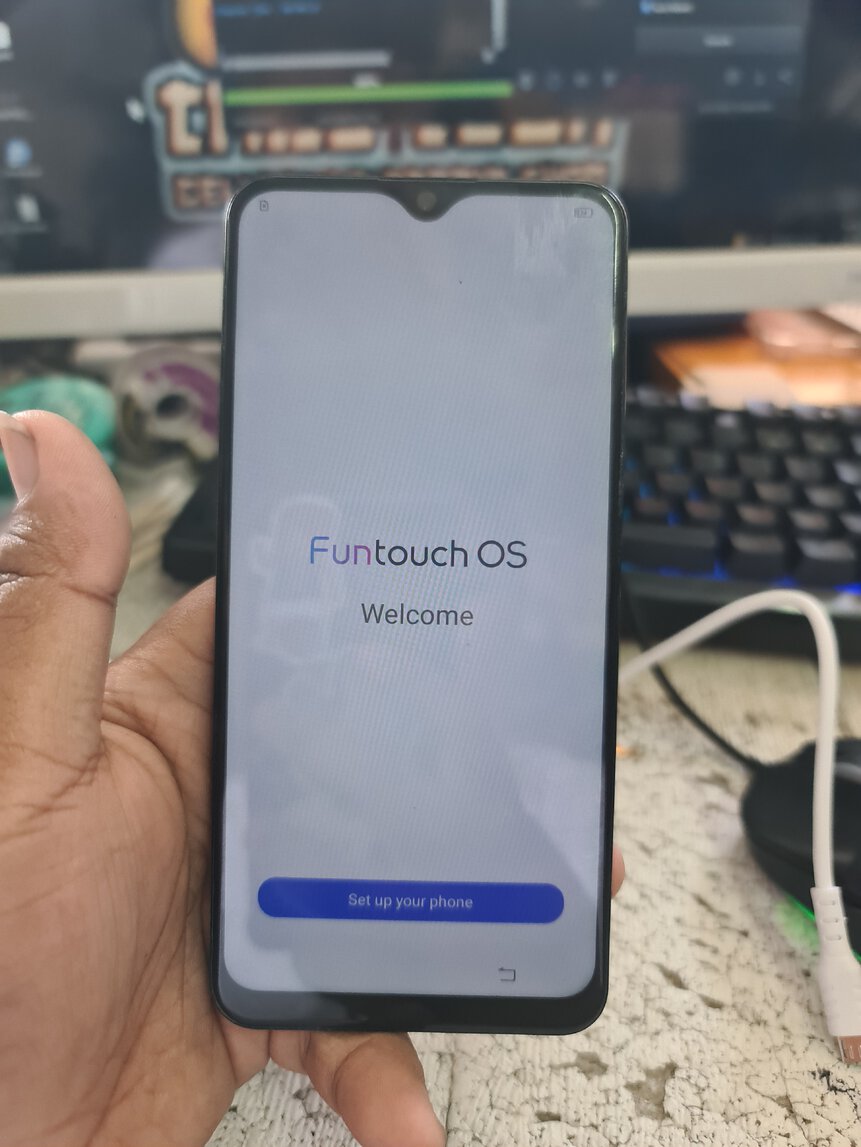

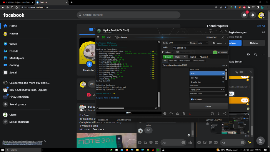

5TH. TAPOS PAG DONE NA SAME PROCESS LANG SA FRP TP PADIN KASO SA FACTORY RESET PROTECTION (FRP) MO NAMAN TITIRAHIN PARA SA FRP BYPASS
THEN PAG TAPOS NON DONE NA

deretso excute ba boss.. pagkaka alam ko sa hydra need mo pa BOOT INFO FIRST..
pede naman sir pero yong akin execute agad na click ko kase binasa namn ng ayos,
minsan sa ibang devices need pa talaga i BOOT bago procedure.
