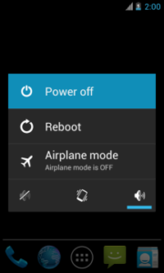

Step 2: Next, switch off your Vivo Y15CW smartphone and remove the battery (it is removable).
power-off-android

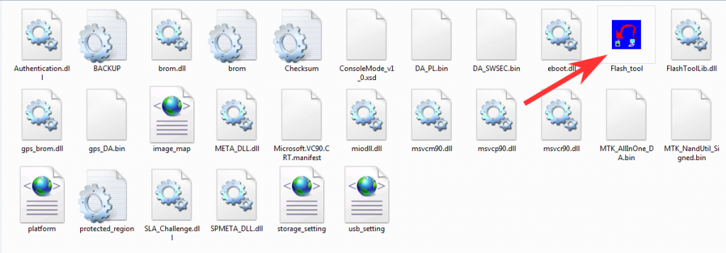

Step 3: Now go to the extracted folder in Step 1 and open up the SP Flash Tool sub-folder. You will find “Flash_tool.exe†file in it. Launch it.

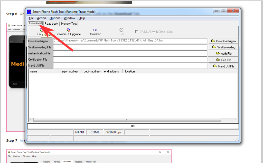

Step 4: Once SP Flash tool is launched, click on “Download†tab.

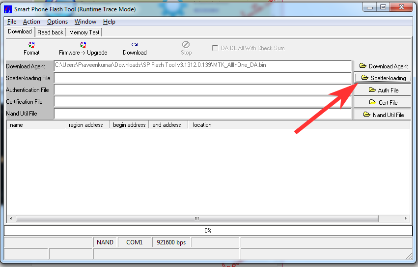

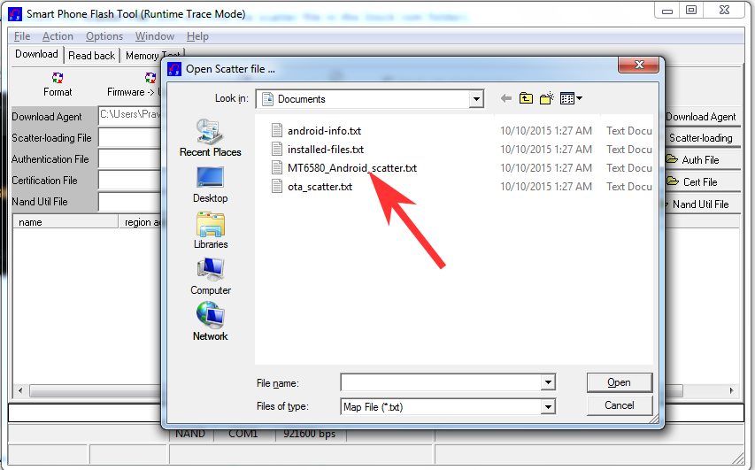

Step 5: Now, click on “scatter-loading†button in the download tab.
stock-rom-flash-process-3
Step 6: Next, click on “Open Scatter File†and select the scatter file from Step 1. For reference see the image given below.
stock-rom-flash-process-4

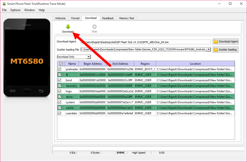

download-ok-green-ring
Step 10: Now, close SP Flash tool on your computer and unplug your smartphone.
