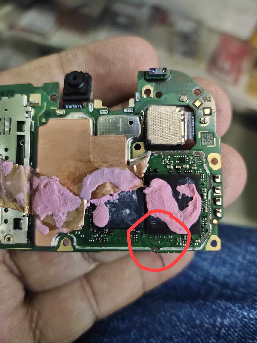

VIVO Y15S FRP VIA ISP HYDRA
NEGATIVE SA MANUAL❌
TESTPOINT❌
SAPOL SA JTAG 100% WORKING
Method
1- OPEN HYDRA TOOL GO TO JTAG-
2- CONNECT PHONE VIA JTAG-
3- REFRESH AND CLICK BOOT INFO-
4-GO TO SERVICE TAB CLICK SAFE FORMAT DAPAT NAKA CLICK ANG REMOVE FRP-
5-EXECUTE-
KUNG NAKA FORMAT NA ANG PHONE DNA MAGLOLOADING NG FORMATTING YAN DIRECT NA SA HOME SETUP MUNA
TESTED 100%
PA LIKE AND FOLLOW SALAMAT☺
