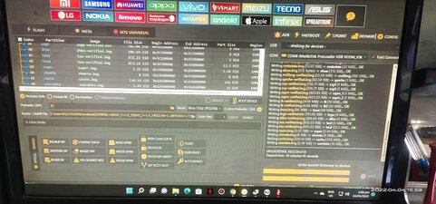

VIVO Y15S PD2140F
HISTORY ISSUE: BIGLANG NA DEAD
SOFTWARE TOOL : UNLOCKTOOL APP
GUIDE:
OPEN UNLOCKTOOL APP
SELECT MTK TAB
CLICK EMI: VIVO Y15S (PD2140F) PARA WALANG ERROR
SELECT SCATTER FILE FOLDER AND OPEN FLASH FILE
THEN CLICK FLASH
NO BOOT KEY JUST PLUG DATA CABLE
WAIT FLASHING UNTIL FINISH
SMILE KANA DONE..

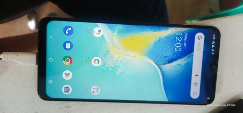

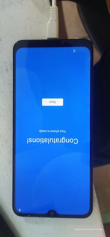

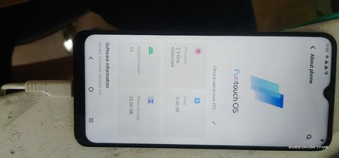

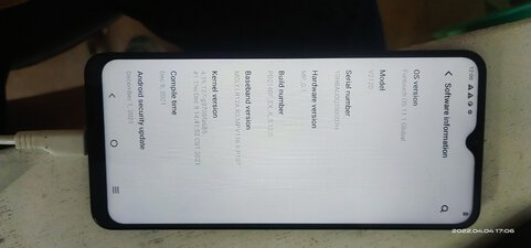

Tested mga boss Vivo y15a Flash ko sa FILE y15s ni MOD,success via Unlocktools,maraming salamat mod,,kala ko abuno na,buti na lang anjan ka isa kang magandang halimbang kaibigan

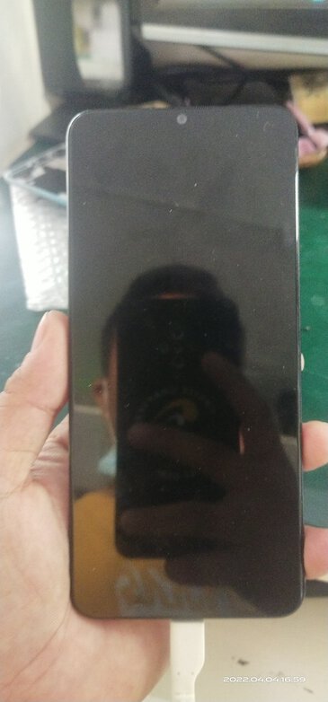

Tested boss sa Y01. dead after remove frp sa UT. maraming salamat
ganun pa rin sir..di maka download yung
link..
ano history ng unit sir? kong pass/frp tas na deadboot i factory reset mo ulit kong ut tas wait mo mabuhay tas marestart ulit yan tas lalabas clear data
