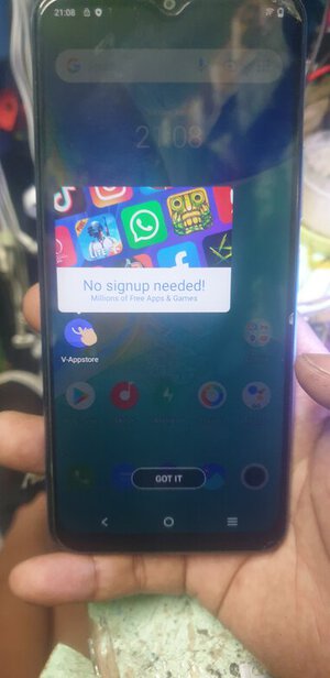

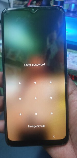

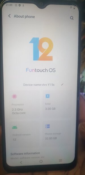

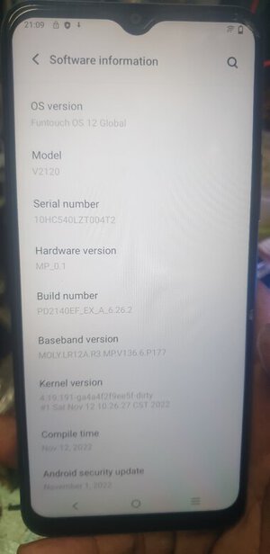

nais ko lang po ito ishare dala ni timer Vivo y15s V2120
Una try ko tanggalin kay UT pero fail na siya, kahit anong gawin ko fail talaga kay unlocktool
siguro dahil mataas na andrion patch level nito kaya naiisip ko na try nalang sa manual format AT DI nMn nabigo
first, off ko muna si unit
Press and Hold the Volume Up key Plus Power key
click: Recovery Mode
click: Clear data
click: Clear all data and ok
click: Return and Restart
at antayin lang matapos, then pangalawang problem is FRP nMn
nag hanap at nag search at ito po nakito ko
sundan lang po itong video
CTTO
Link:
vew my ss
maraming salamat po nawa'y makatulong
