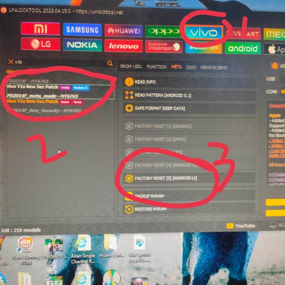

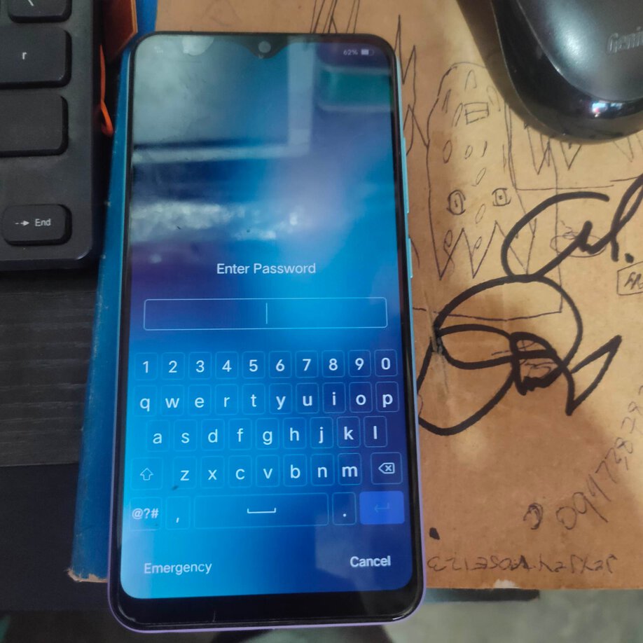

Mga Luds Share ko lang itong natanggap ko na vivo 2015 y1s password
Procedure
open unloock tool
select vivo tab
select model y1s meta/factory5
select factory reset 5 android 11
insert usb no bootkey
wait until done
