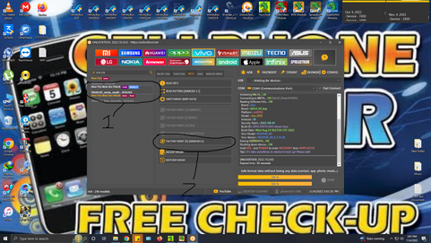

Good Day Mga Master Share KO Lang Itong Tanggap Ko Na VIVO Y1s Password Problem

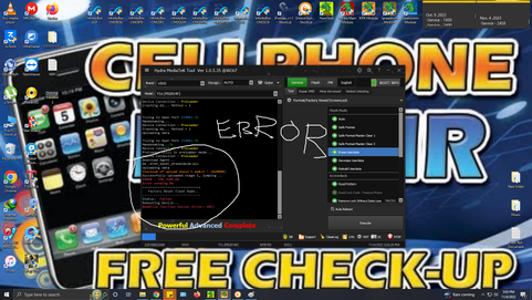

1. Try Ko Sa HYDRA TOOL Pero ERROR po Result
2. Try KO Din Sa U.T. Error din.. Kaya Try Ko E METAMODE siya kaya Ayun Nag OKEY siya.

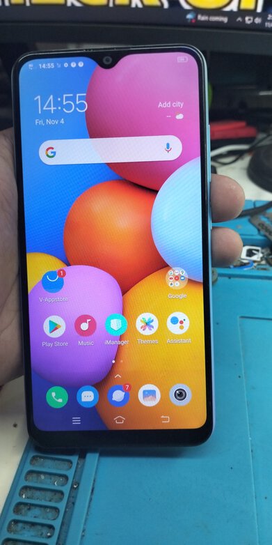

3. HARD RESET NYU NA NALANG PO after di na po yan mang hihingi ng CODE.
4. DONE!!!!!!
Maraming Salamat Po.. God Bless Sa Lahat.
