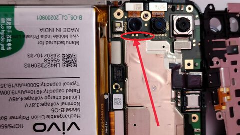

1. Baklas Unit para sa TP baklas din Batt para safe

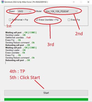

2. Download this tool: https://mega.nz/file/2C4VQKoT#PBNPWe_f9Xq1AEZ1B9xuVmhcmGpGxOKf5HbvsAWDc6I
3. See Pic Below
4. Ung sa FRP hndi gumagana jan kaya ang ginawa ko Manual Bypass using Set Screen Lock to Pattern ayun ok na ung Unit:

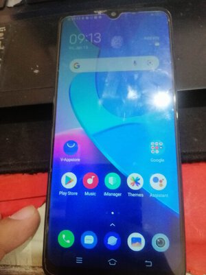

5. Eto Result:
