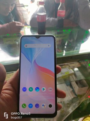

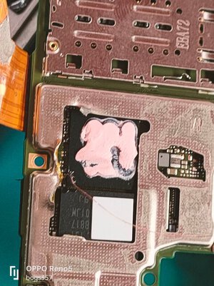

Vivo y21s Password and FRP New Sec. removed by HYDRA via TP DONE!

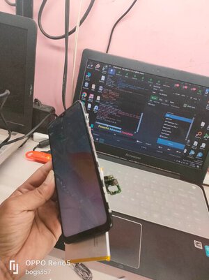

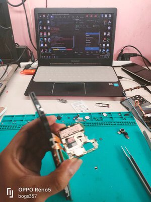

Open hydra Click MTK
In option
Uncheck Enable Prel.
uncheck force Preloader
wala sa list ang y21s so click mong model y15s

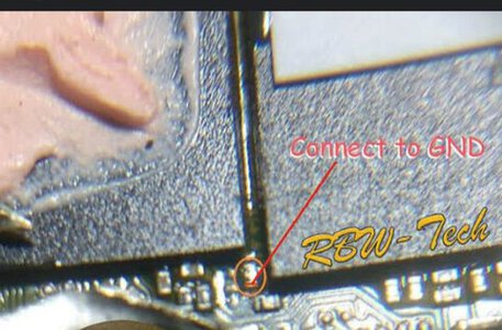

*BootInfo(Connect TP)
*Ultra Power
DONE!!!
OT: sa google ko na kita TP pero TESTED

grabe ung new security ngaun.need pa tespoint jumper bago mag connect.
lintik na brom yan.hehahe.
pahirapan n mtk ngaun.hayss
