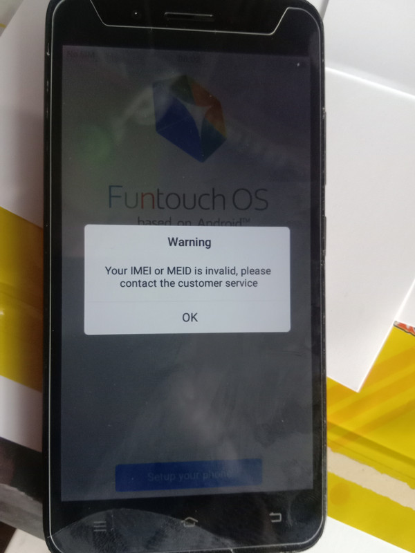

Yan nga po GInawa ko sa Flashing boss kaya lang pagka ok na unit yan na IMIE nya poh. . .My iba bang paraan maayus IMEI Nito ?try this method lods tested kona yan
https://antgsm.com/forum/threads/vivo-y53-hang-then-auto-restart-done.206159/
How naman po Boss Pwede Pa guide Akoneed to downgrade yan para may write imei sa umt
Cgi try koCM2QLM sir, try mo
ano po method ginamit mo boss? di ko magamit umt ko kaka-expire lang kasi...SOLVE
via hydra tool naman po tested ko din
1. via qcom flasher Vivo_Y53_PD1628F_EX_A_1.11.1 Downgrade File
2. via recovery PD1628F_EX_A_1.11.1-update-full no imei fix.zip
3. use hydra tool diag mode *#558#
