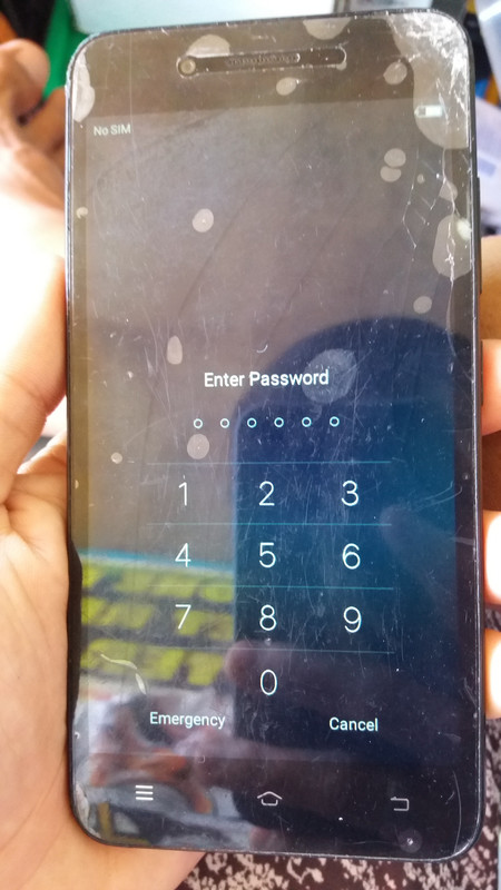

vivo y53 done via mrt dongle

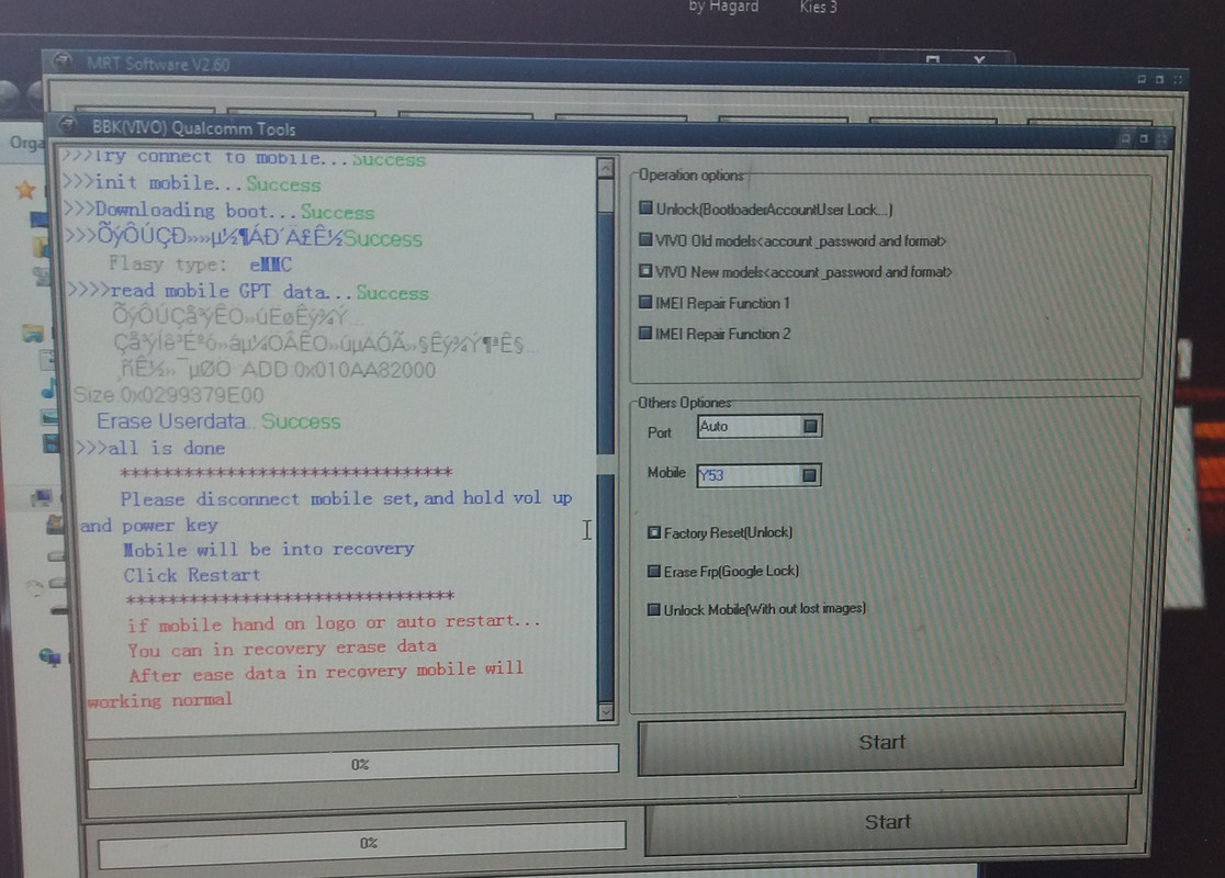

open mrt
click VIVO_QC
click vivo new models
select y53
tick factory reset (unlock)
hold volume up and down
connect to pc wait hanggang mag install drivers
then click START
wait hanggang matapos
note; pag nag hang sa vivo logo
off unit then press volume down and power lalabas system recovery mode

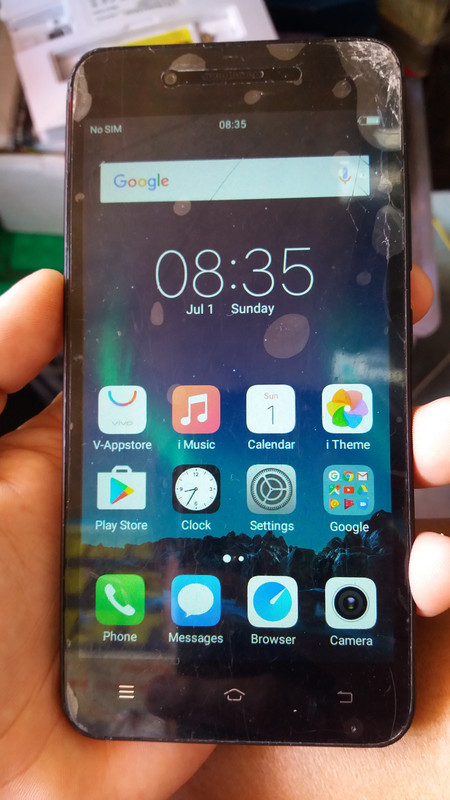

select system repair mode antay lang magreboot at pera na:)
