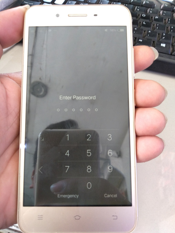

History:
Nakalimutan pattern
Action taken:
try hr pero wala naka lock sa google may pattern pa rin

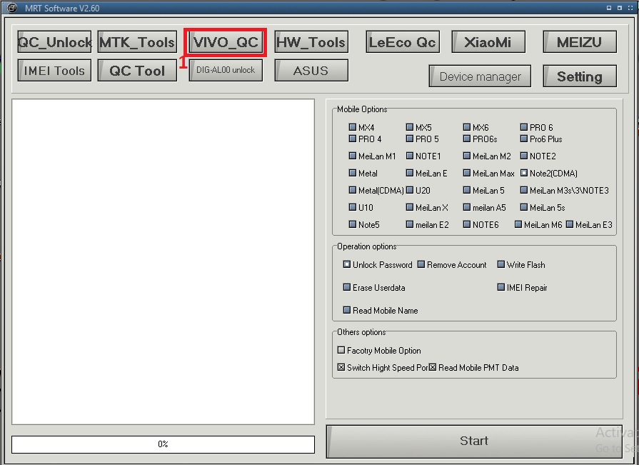

kaya gamit na ako mrt dongle
sundan lang po ang ss

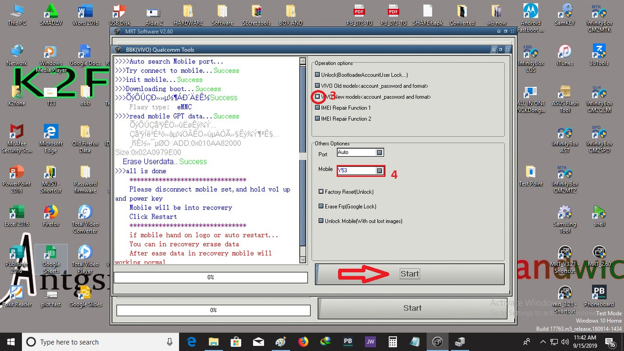

Bago click start saksak muna usb sa unit using boot key na vol up and down
install driver if needed pag connected saka hit start
remove usb

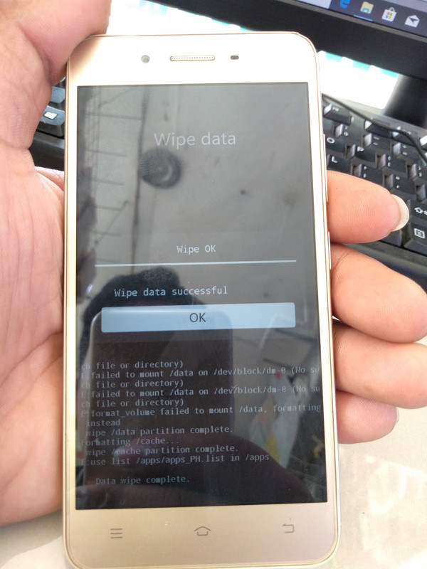

long press click power plus volume up wag muna mag perform ng wipe data dahil mag failed siiya
gawin natin reboot system hantayin mga 1-2 minutes saka natin long press power+ volume upat perform na wipe data

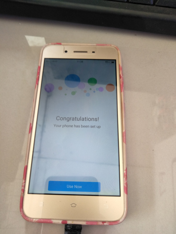

sucess na yan at reboot phone done.
