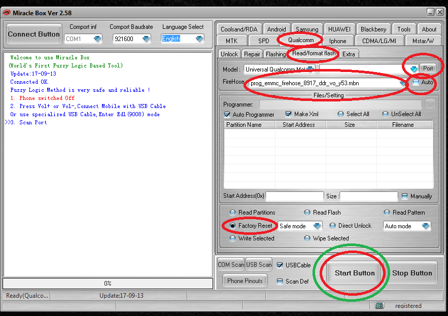

VIVO y53 vFast Remove passcode, free firmware
bahagi kulang mga ka antech
sana maka tulong to.
1.power off your vivoy53
2.press both vul-up & vul down - then insert usb cable
3. sundin ang nasa picture.
pag succesful na. power on niu na ung phone ok na
sorry walang actual pic sa Phone. nagmamadali ung may ari..
Firmware Link - Miracle Crack
https://www.4shared.com/rar/EDMRQYncfi/Miracle_258_without_box.html
