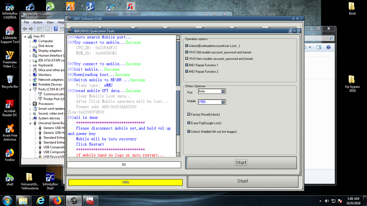

share ko lang mga boss vivo y55s(1610) pattern lock done sa mrt dongle..
procedure..
open MRT software
select VIVO-QC
select VIVO new models<account_password and format>
port auto
model y55s
select factory reset(unlock)
power off your phone and hol vol up and down and then insert usb cable
hit start...

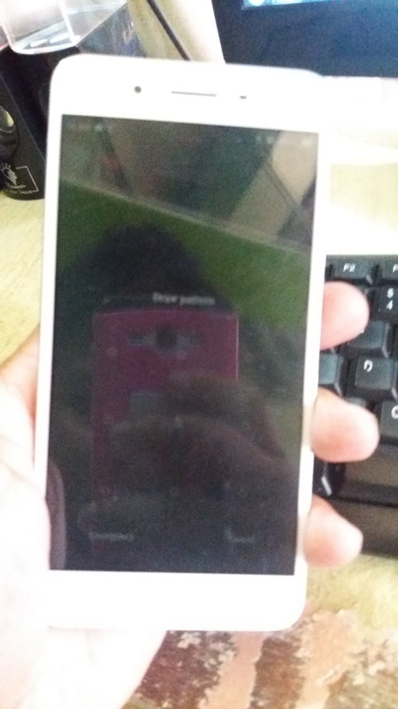

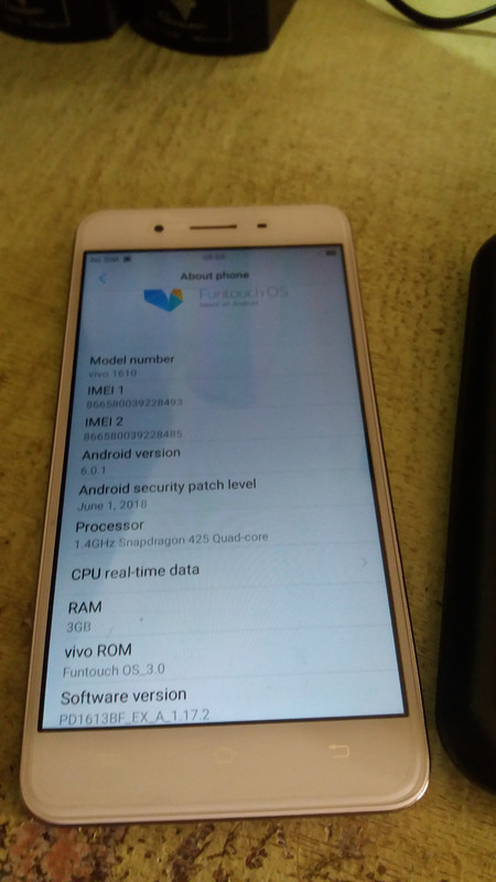

same procedure lang po cla sa vivo y53 after factory reset sa mrt dongle hard reset nyu lang po...
picture..
DONE...
