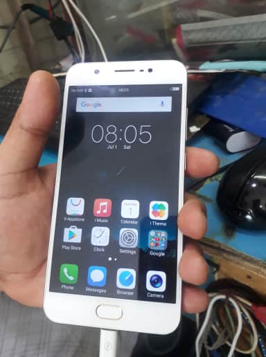

21volcano

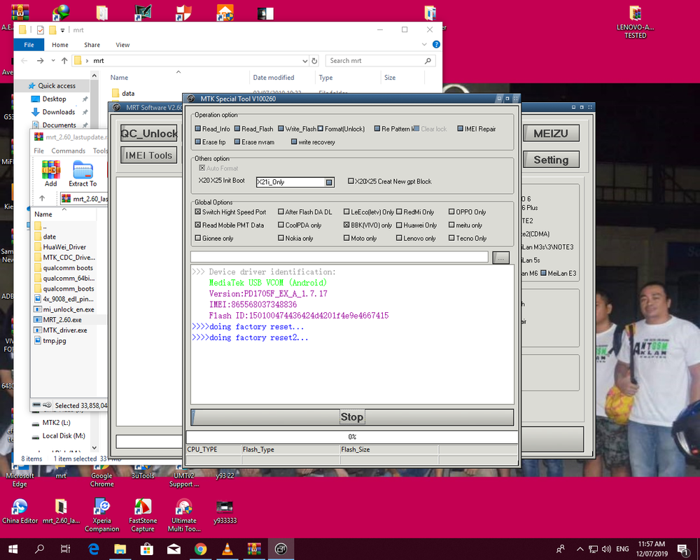

need mo mrt
una sa lahat need off the phone
then hold vol+ then advance then reboot adb.
then open mo c mrt v2.60 format then click bbk(vivo) then x21i only then salpak mo si unit the click start

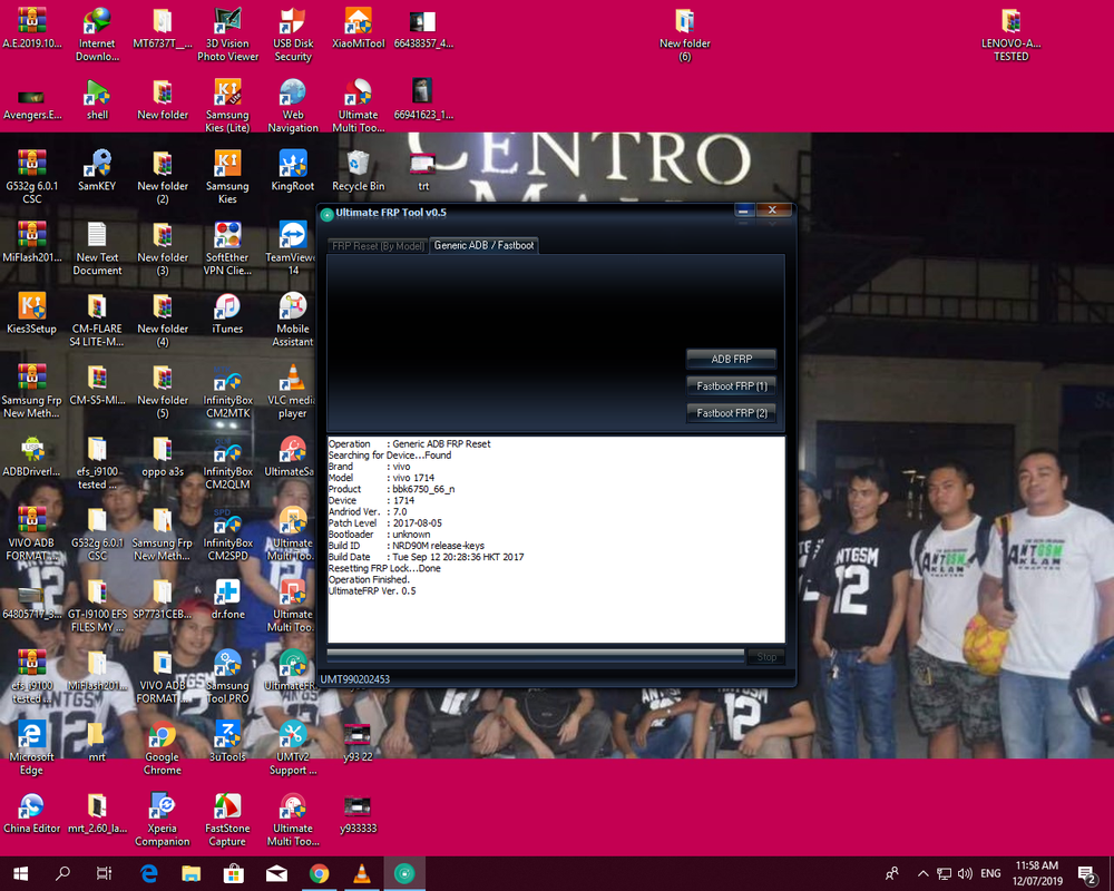

tapos may frp pa need frp abd remover ginamet ko dahil may umt ako sa ultimate frp tool ko tinagalan ng frp
done 400 lang barat kasi si tomer
