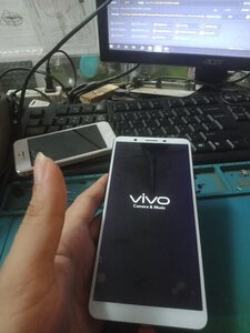

issue: auto restart (try palit battery at tanggal switch pero no luck)

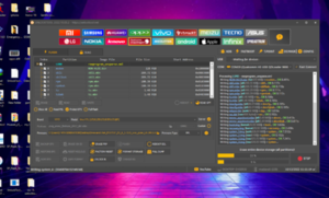

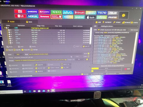

program gamit unlock tool
download file here: android file host credit kay boss Nasher@25
download file and extract

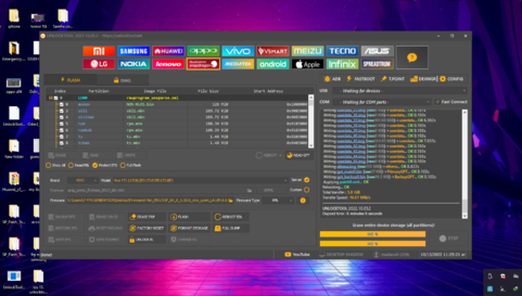

open unlocktool
select qualcom
check server
select brand: vivo
select model: vivo y71

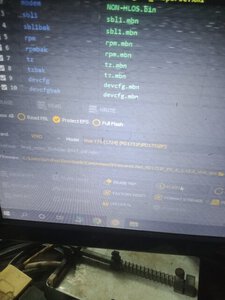

select firmware folder
select "rawprogram_unsparse.xml"
click flash

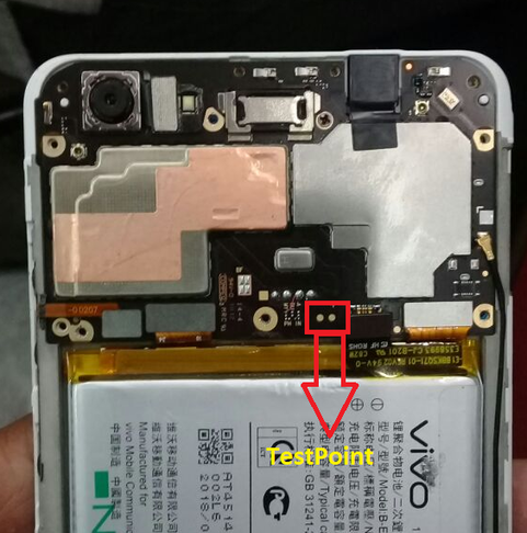

turn off unit baklasin at tanggalin ang battery
testpoint

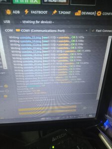

insert usb
wait until done

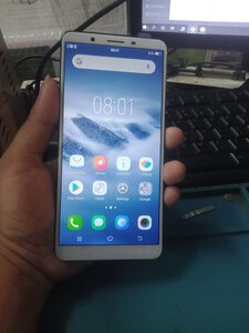

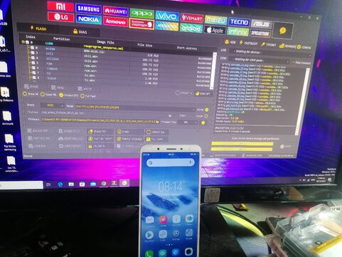

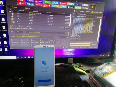

wait until done
Tested
