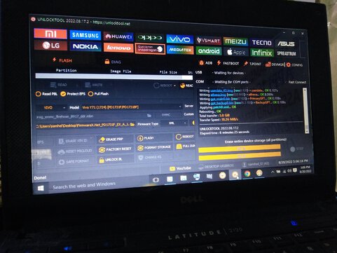

Tested Thanks dito boss. 296157165_1189605668279286_8591698883283358869_n.jpg

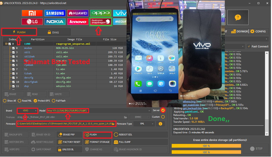

salamat boss tested

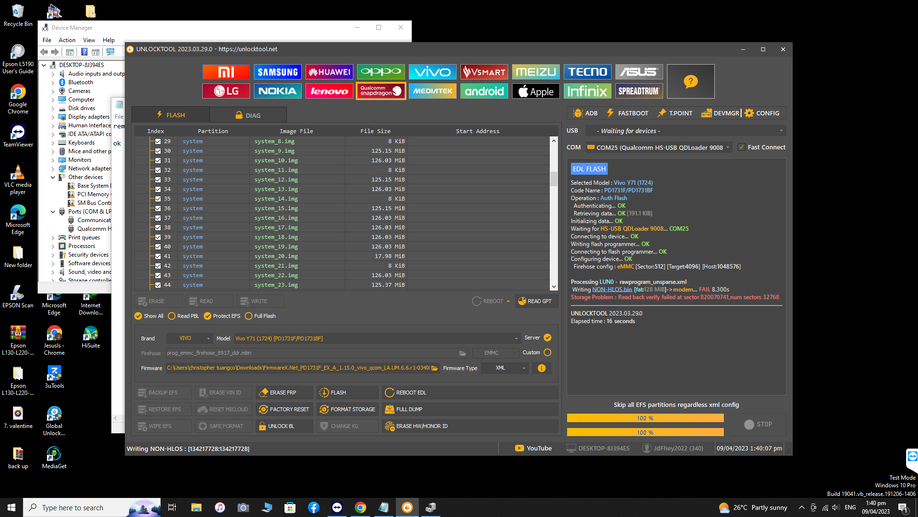

Boss ano po kaya problema ayaw po magtuloy. Storage Problem: Readback verify failed at sector. Salamat po in advance
