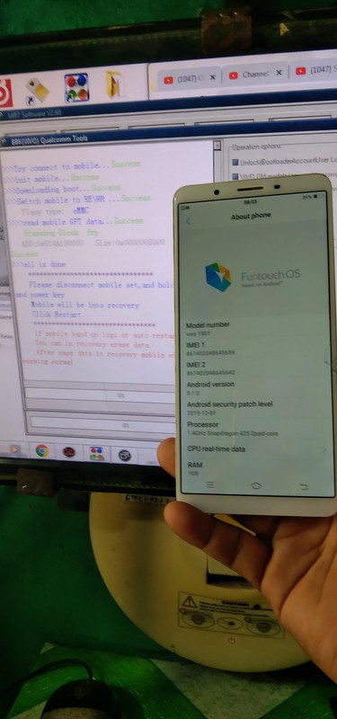

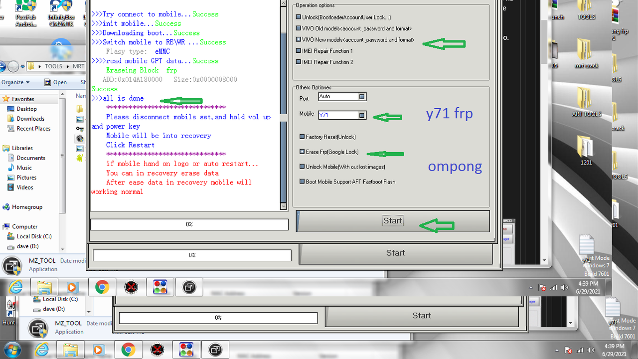

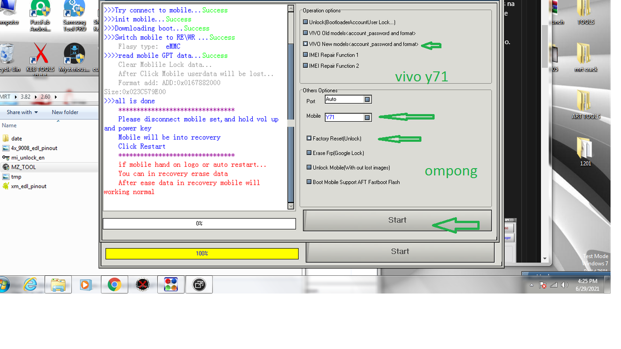

open mrt 2.60
CLICK vivo qc
click vivo new model
mobile set to y71

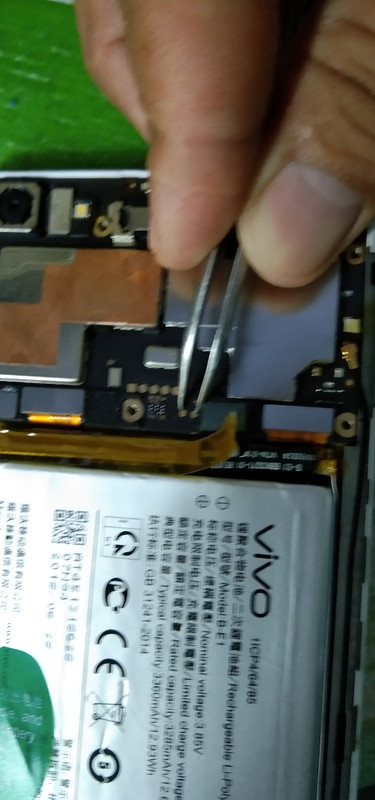

test point
pag detect click start
click factory reset
same procedure sa frp,,
TESTPOINT..
SALAMAT PO,,,,
