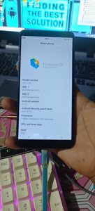

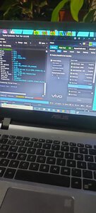

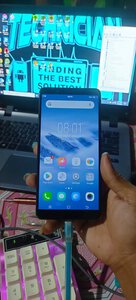

Vivo y71 password & frp done ki hydra.
Step:
Open qualcom module
Select
Brand VIVO
model Y71

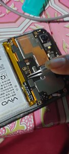

Baklas si unit for test point
Click vivo
Chose Factory Reset/format data
Click bot info
Click execute
TP si unit then plug USB
If detected na remove TP
After bot info done unplug USB cable
Click force erase and wait until done.IMG20220802194915.jpgIMG20220802194756.jpgIMG20220802194740.jpgIMG20220802193938.jpgIMG20220802192233.jpg
